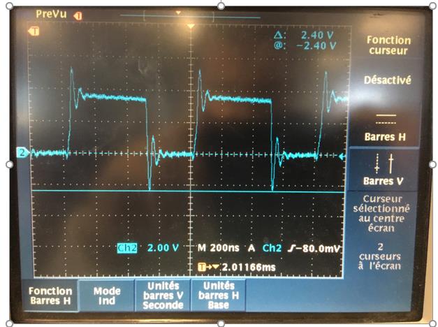

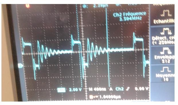

SW signal on a defective board in Power Save Mode:
SW signal on a good board in PWM Mode with a 100mA load:
SW signal on a good board in Power Save Mode with a ~5µA load:

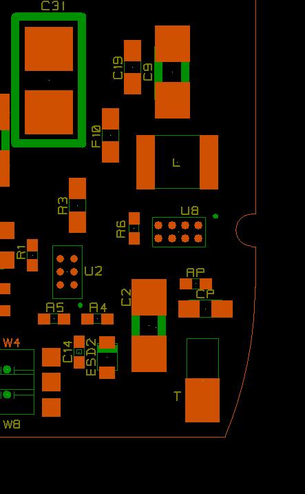

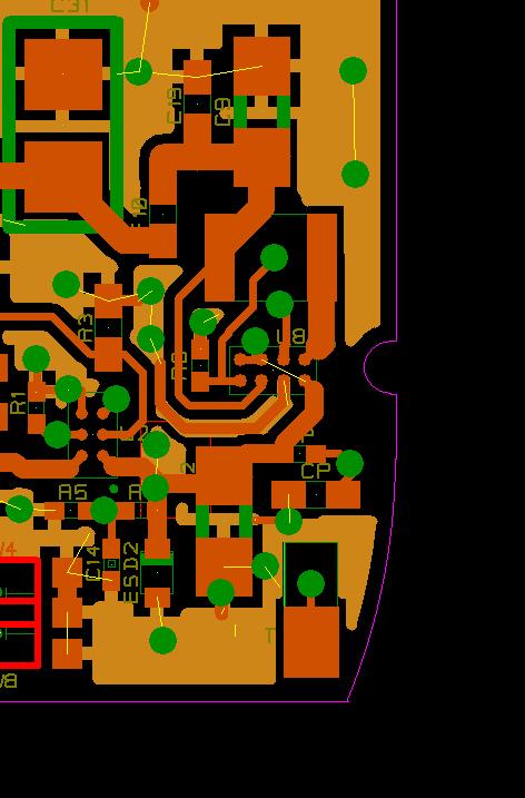

Here are the schematic and layout if it could help. Lout is a DFE201610C. Cout is a GRM188Z71A106MA73:

    Can you share the raw measured values (Vin, Vout, Iin, Iout) for a passing and failing input current test? The first waveform shows a 2Vout, while the third waveform shows 3.3Vout. What do they have in their application?

    The schematic looks ok, but the layout is not done perfectly. The input and output cap's GNDs are not connected directly to the GND pin. It looks like vias and a long trace are used.

    Vin=3,9V ,Iout=5uA ( power safe mode)
    Endeed The third waveform shown 3.3V because vsel3/2/1="1"

    You're right Actually The input and output cap's GNDs are not connected directly to the GND pin. according to you this can deteriorate the SW pin waveform? or break the DC/DC ?
    I guess the ringing allow the output ( MOS &PMOS) to switch with bad timing so makes Overconsumption ?
