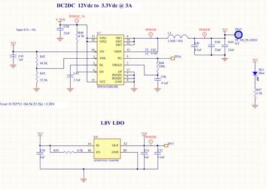

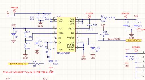

  1. Below you can see PS based on TPS54326RGT
           VO=5.4V
           What is min. VIN?
2)
.       Pls. review the schematics below.
For Buck:
Vin: 4.5-18V.
Nominal 12V.
VO=3.3V, IO=3A.
