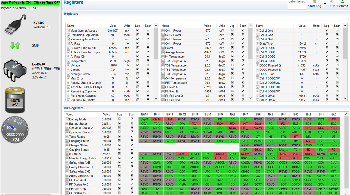

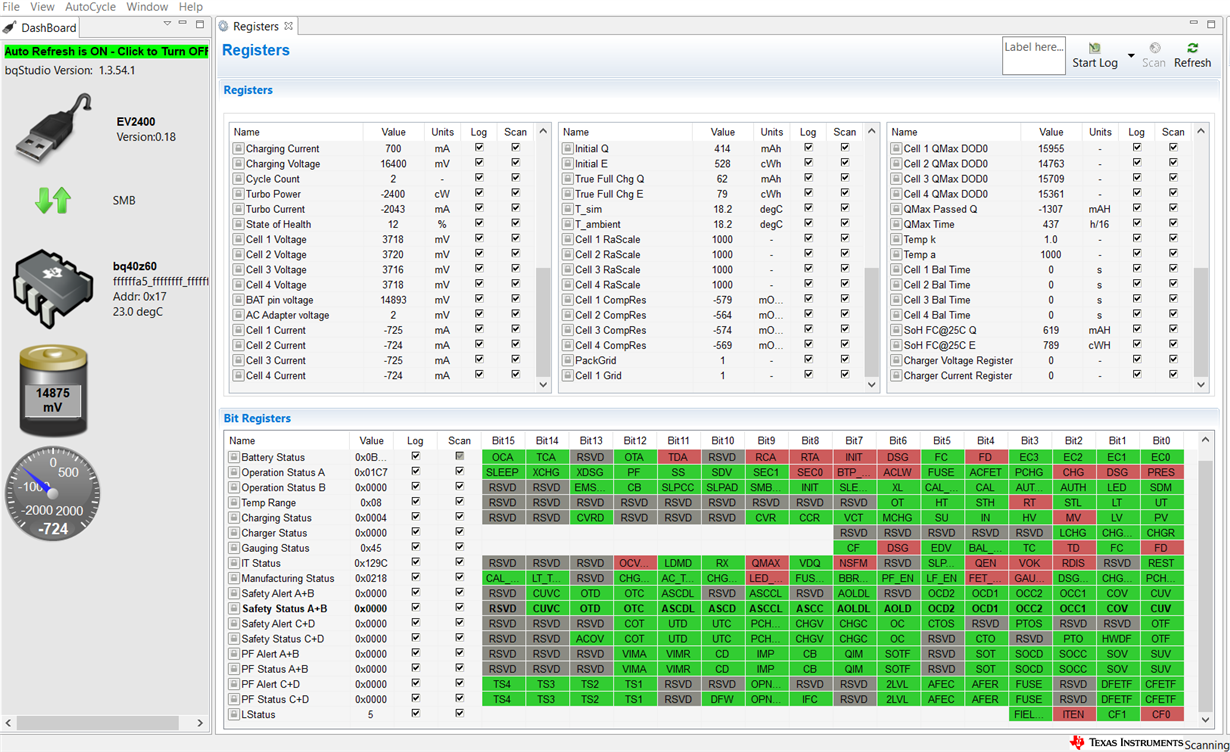

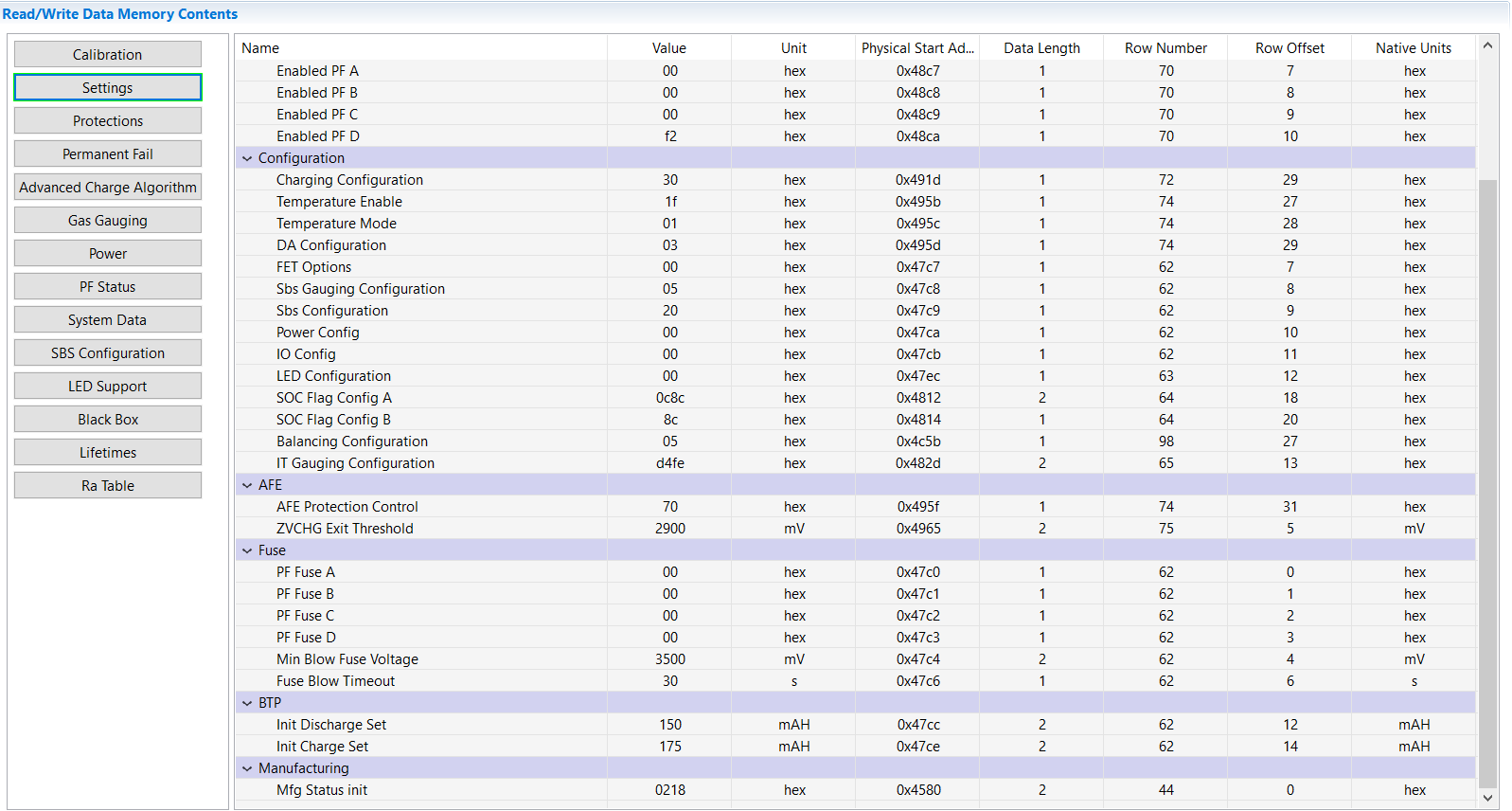

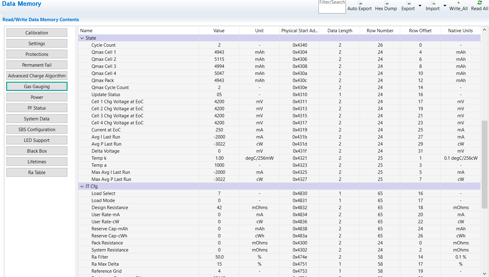

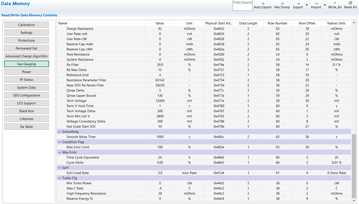

    I ran learning cycles over the weekend. The CHG and DSG FET's switched at the proper cell voltages. The RSOC and ASOC values are not working. With ce ll voltages at 3720 mV RSOC = 4% ASOC = 3%. At cell voltages of 4195 mV, RSOC = 100%, ASOC = 98%. I have captured  my register screens and the Settings and Gas Gauging screens. Please advise what you think I am doing wrong.
    Relax time were about 12 hours.
    Jerry
  • Hi Jerry,
    Don't pay too much attention to SOC at this point. You need to follow the instructions I provided to you. Discharge to Term Voltage (3000mV/Cell or 12000mV pack) that you set in data flash. Rest for 5hrs then charge to charge termination voltage (4200mV/Cell or 12800mV pack). Rest for 2hrs then discharge to Term Voltage (3000mV/Cell or 12000mV pack).
    Prior to running learning cycle ensure update status is set for an unlearned gauge (0x04). After successful learning cycle update status should be 0x06. Also ensure Ra Flag is set to 0xFF55 or 0xFFFF prior to learning cycle for all cells.
