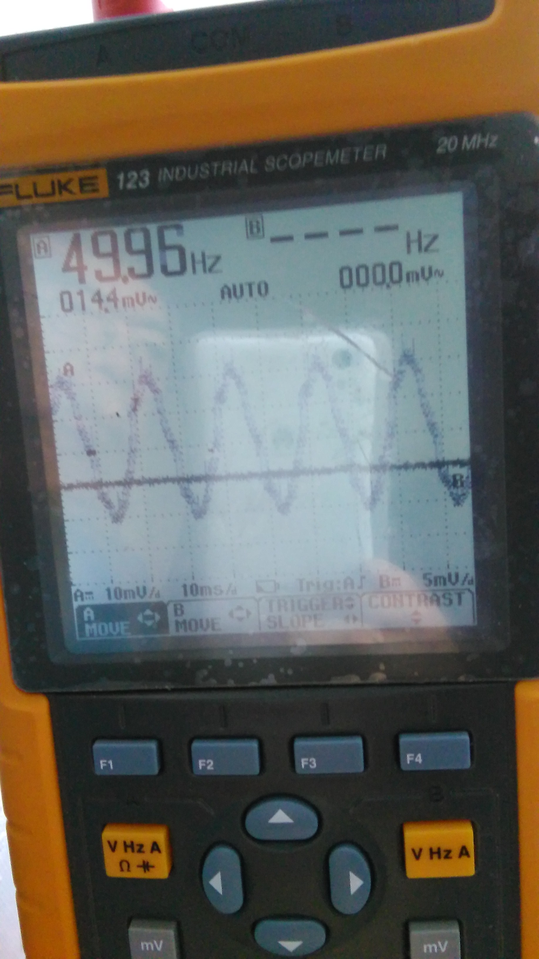

The PCB has finished but there is no output across Cout. I checked Vcc that is 7V. I didn't find out other check values from the datasheet. How is it checked to figure out causes?

    1. make sure Vin is present and stable
    2. check SD pin and verify that device is enabled
    3. place oscilloscope probe on SW pin and verify that device is swithcing
    4. check voltage on FB pin
    For all the signals above try to capture waveforms.
    Also if you could provide schematic of you design that would be helpful.

  • Thanks for your support.
    Vin=24V
    SD is not connected.
    FB=0.63V
    SW
    The schematic from WEBENCH
  • From your screenshot it looks like the part is not operating. There is no activity on switch node other than some 50Hz noise you are showing.
    Suggest trying following:
    1. Enable SD pin by either pulling it high to ~2V (using an external power supply) or connecting it to Vin through appropriate resistive divider and observe part behavior. Make sure not to apply voltage higher than 14V to this pin. It will damage device.
    2. measure voltage on VCC pin
    3. with SD pin pulled high measure voltage on output and FB pin
    Brani
