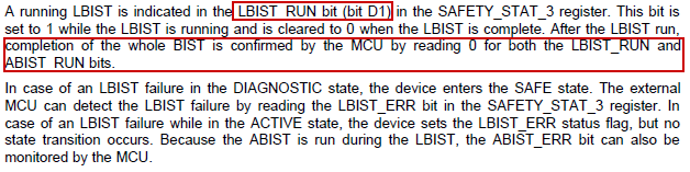

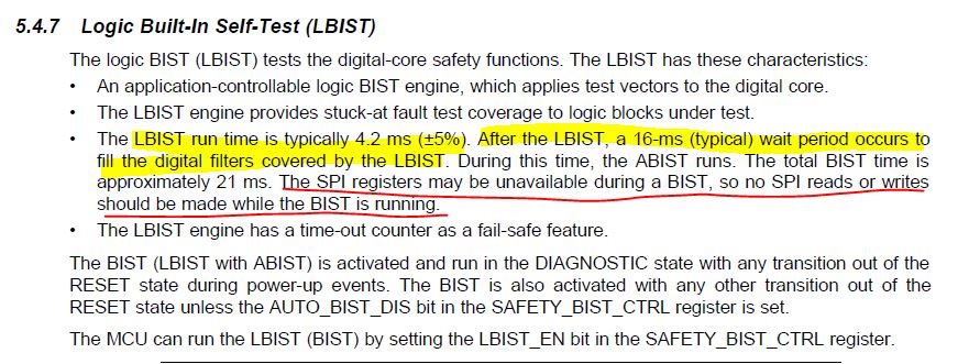

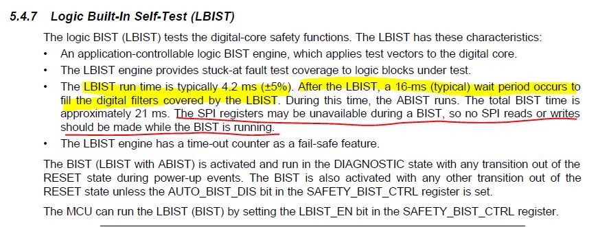

in the SafeTI™ Hercules™ Diagnostic Library Release Notes (v 2.4.0) there is the following known issue:
We develop a system in an industrial application which is running for several weeks or even months without restart (which would force ABIST / LBIST). From my point of view there is no possibility to guarantee that the TPS is working properly because it can't be tested anymore without the risk to get a power reset.
Do you have any idea for a workaround or an argumentation whether it is still useful in this application?
