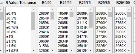

    Understood. However, in datasheets or Digikey searches, it is not so straightforward. See the following parametric filter snapshot from Digikey's thermistor catalog:
    So, which is the B-Value B0/50, B25/50, B25/75, B25/85, etc?
    In a random datasheet (attached), the parameter is listed in a table as B25/100. Is this the correct B-Value?
