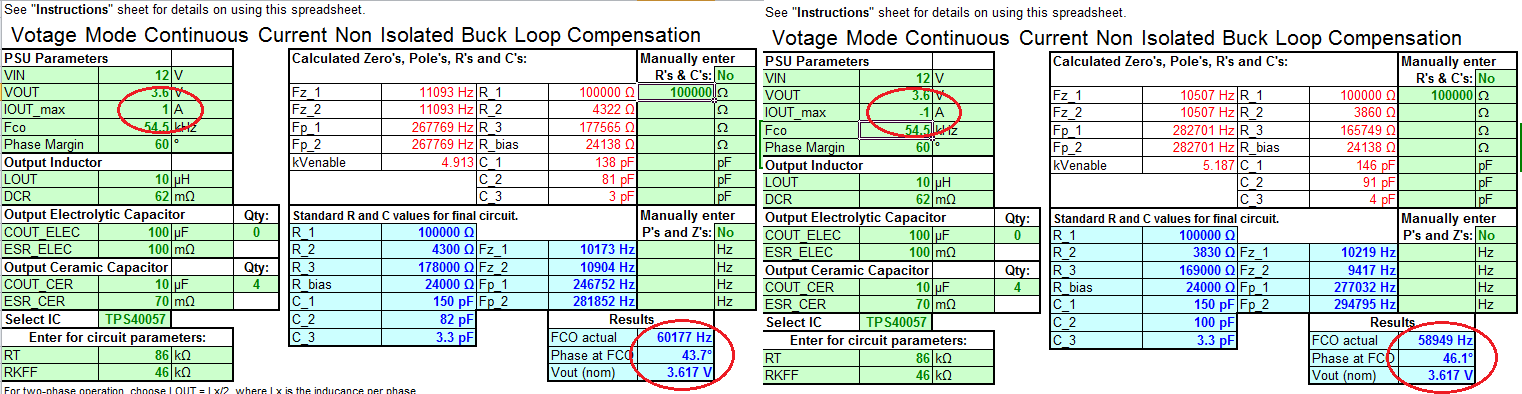

I am considering TPS40057 for VCOM of LCD circuit.
I will attach the circuit diagram and calculation result I created.
The constants of the circuit diagram are provisionally input. The final constant value is still under consideration.
I would like to ask about the phase compensation constant.
In my specification IOUT is both sink and source.
I entered "1" and "-1" in the IOUT_max field of the Excel sheet, but the phase margin is "1" worse.
Should I choose the phase compensation constant when setting "1"?
(specification)
VIN : 12V ± 1.2V
VOUT : 3.6V
IOUT : ±1A(typ), +1mA (min)
Ambient temperature: +85°C to -40°C
