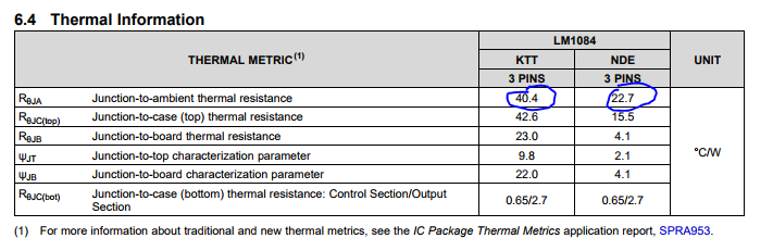

Could you tell me the transient thermal resistance of LM1084?
My customer's usage is follows(with heatsink);
VIN=12V, Vout=7V, Iout=1.6A(during 5sec)

Hi Kuramochi,
Since your pulse duration is 5 seconds, your transient thermal resistance after 5 seconds is pretty much similar to the one on the datasheet under thermal information section. Unfortunately we don't have the data for the transient thermal resistance from 0 seconds to 5 seconds.
