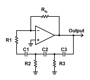

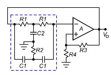

  • Which of the following circuit structure is used for the internal RC oscillator?
    Or, is the other circuit structure used?
    Phase Shift Oscillator
    Twin-T Oscillator
    Tamio
  • Hi Tamio,
    It is a custom design based on the single ramp relaxation oscillator concept. I cannot provide further information regarding the internal IP of the chip.
