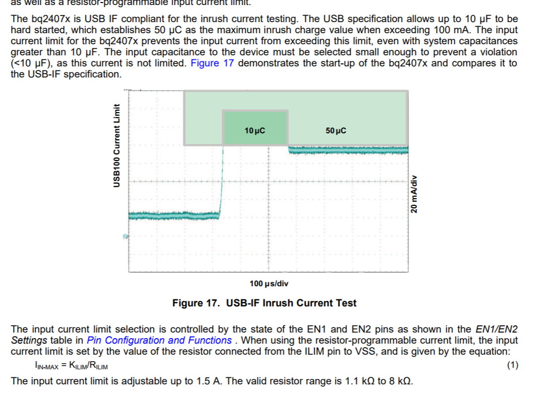

We got a question from my customer about BQ24072
Could you help us ?
Please tell me about battery discharge.
When inserting a lithium-ion battery, is the battery voltage output to the system side without any special control?
Also, at this time, is there a rush current prevention function?
Thanks.
Best regards.
    The device acts as a pass through and the only difference between the OUT voltage and the BAT voltage is drop across the BATFET.  The rush current prevention function is described below as in section 9.3.4.1 in the datasheet.
