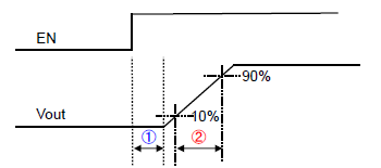

①In the equation (1) of the data sheet P11 of TPS563210A, is the unit required for calculation correct as follows?
CSS:pF
ISS:uA
※According to this, we believe that Tss = 0.9 ms when Css = 8200 pF.
②Which does Tss (ms) indicate the time of "① or ②" of the following waveform?
 If Tss = ②, please tell me the approximate time of ①.
③Which is PG pin "OPEN (FET-OFF)" or "0V (FET-ON)", if Vin = 12V and EN = 0V ?
※In the waveform of data sheet P16(Fig.17) of TPS563210A, since PG is pulled up by Vout , the state at EN = 0V is not understood.
