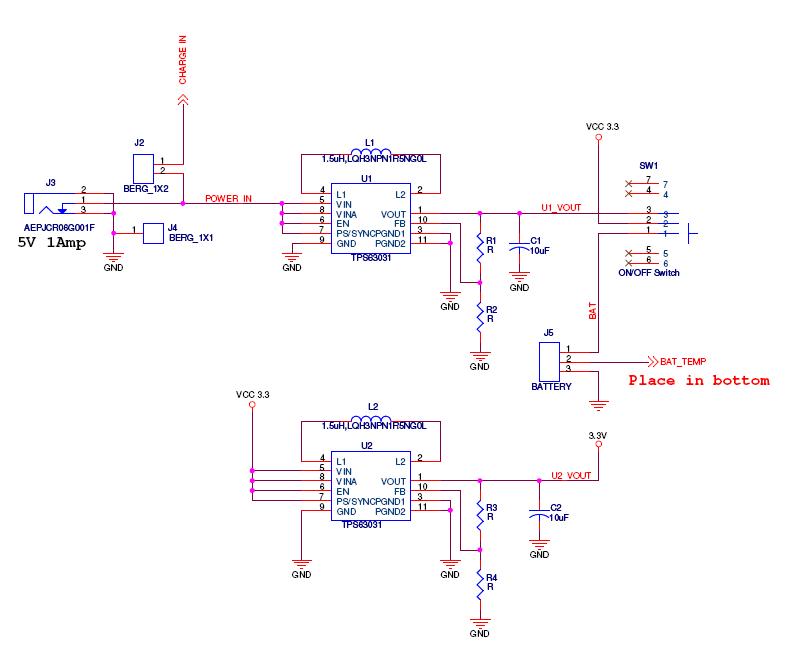

  • Hi Chris,
    I'm facing some problem with TPS63031..
    my new design consists of two TPS63031, as shown in the attached schs.
    I'm provinding a supply of 4.2v ,800mAh.. but I'm not getting the proper voltage at the output of IC U1(first regulator ) and nothing at the U2 . Just getting 0.3v at V1out.
    what may be the problem .  I need 3.3v at the output to run mu system..I'm using standard inductor which is specified in the datasheet (i.eLQH3NPN,1.4A ),
    since I dont want any voltage devider so I sorted FB to Vout put. by '0'ohm at the R1 and R2 is open (from schs)  .
    regards
    chethan
  • You have no input capacitors shown on the schematic.  These are required for each regulator to function.  Please see the datasheet for the recommended value.  Each regulator needs their own input capacitor, placed right next to the IC.
    You can also order the EVM for the TPS63030 and evaluate it first.
  • I also see that your schematic shows the output capacitor drawn as a tantalum or electrolytic.  I recommend ceramic output capacitors.  If  you choose a tantalum or aluminum electrolytic, please place a high quality ceramic capacitor directly at the output of the TPS63030.  Please refer to the capacitor selection paragraph for more details on capacitor selection.  It is very important that the input and output capacitors are properly placed and routed on the PWB.  Please refer to the EVM for guidance.

  • The IC requires both an input and output capacitor to function.
    You need to debug your circuit piece by piece.  First, make sure that all your solder joints are good and that there are no shorts between the pins on the board.  Ohm out each pin to make sure they are connected to what you think they are connected to.
    Look at VIn with a scope.  Make sure it is DC and stable.  Supply Vin with a lab supply and make sure the lab supply is not current limiting.  Disconnect any loads.
    Next, is the IC switching?  Look at L1 and L2 for any signs of activity.
    etc.
    You can order the EVM and evaluate its performance to get a feel for how these ICs operate.  The EVM is fully tested and will work.
