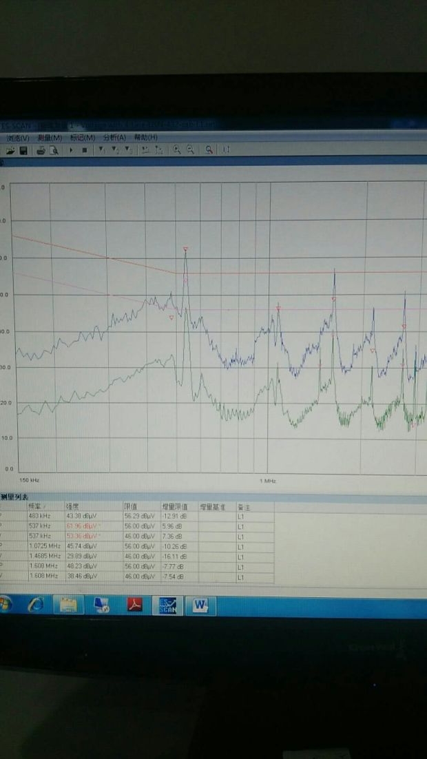

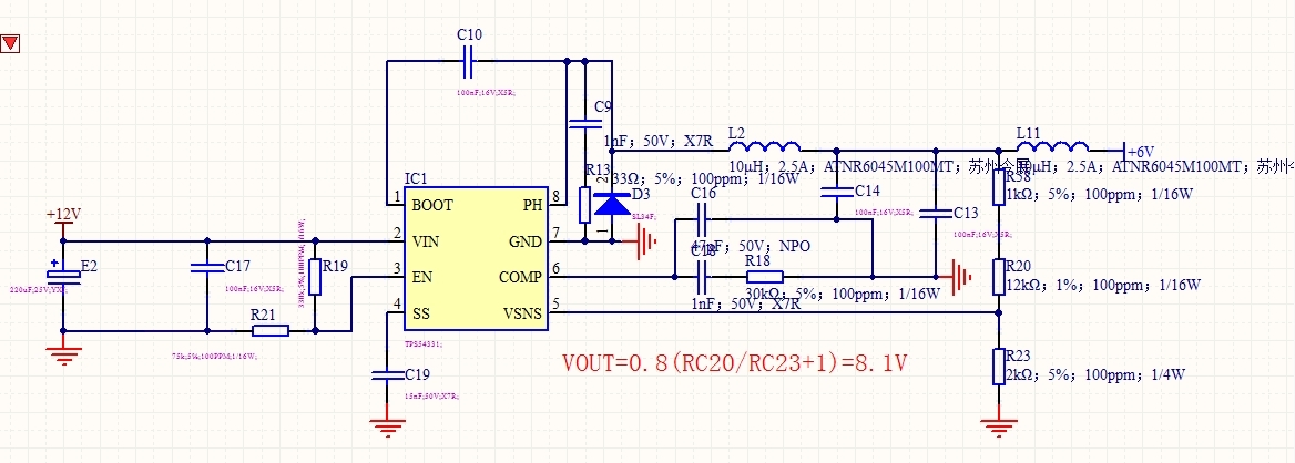

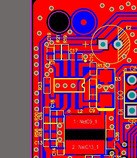

Dear,
   Can you give some advice of the design below. The CE is now exceed.
