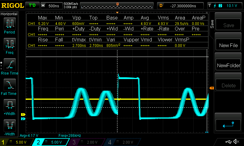

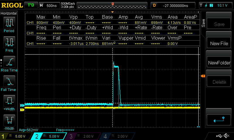

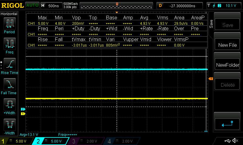

  • 13vin, CDRH127 68uH inductor, CPH6354 fet, B360B diode, 33uF+1uF at output:
    Yellow Vout, Blue Vin:
    Blue Switch node (weird...)
    Blue, TPS40200 pin 6
    With 100mA load the damping in switch node is dissapeared, only spikes left. with little bit more load (110mA for example) stops working (0V at output) and a square wafe of 6,5% on duty is on the switch node..

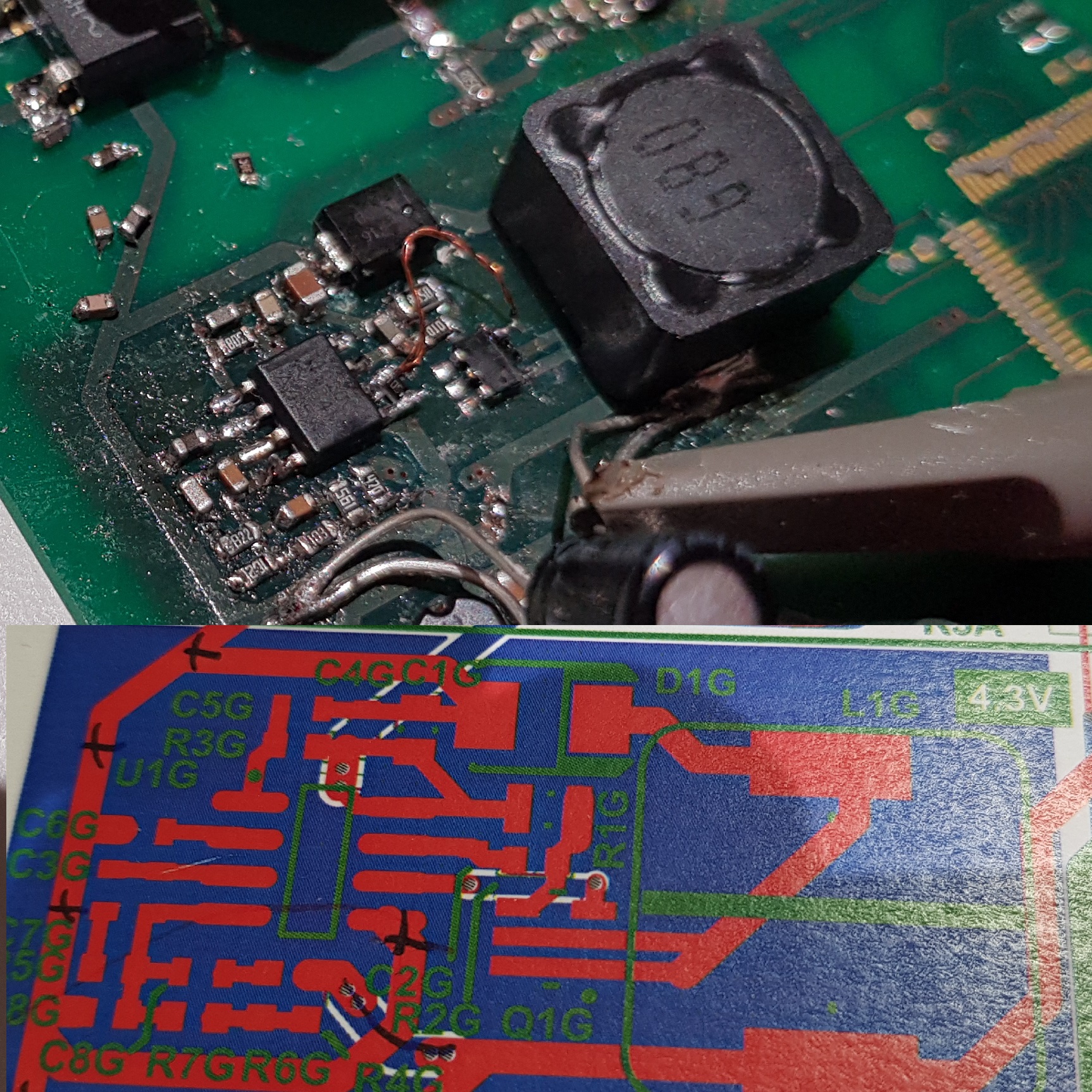

    This is the board. It is a prototype, not too clean, but I dont expected to work so bad :/ (the wire from TPS40200 pin 6 to the fet is in paralell with PCB wire (I wanted to test if was a wire impedance problem...)
  • All switching regulators are sensitive to layout, not just TPS40200. Since it is a controller, you have to layout the external FET and diode, it makes the layout more complicated. If the operation range you need is Vin=12V-48V, load = 3A max, as stated in the schematic above, you may consider a non-synchronous buck such as TPS54360, TPS54560, LMR16030 (non-sync regulator has high side FET integrated, you need power diode on the board), or you can consider a synchronous buck such as LM76003 (sync regulators have both high side and low side FET integrated). The PCB layout is easier with FET integrated.
    For the layout above, the key element is to keep the area enclosed by Vin cap (C9, C1), R6, Q1, D1 as small as possible. This loop and these components contains pulsing current, which generates more noise if the loop area is larger. I didn't find C9 on the layout, I think it is the two caps at the left hand side of D1. C1 shouldn't be open, it should be a 1uF high voltage cap for bypassing. When the ground trace goes from D1 around the IC to the IC ground, all the compensation and feedback components tied to this ground trace will pick up switching noise directly. The gate drive signal also contains pulsing signal, with much lower current though. It is not good to have it fly over as it is now.
    How many layer is your board? To verify the design, I'd suggest modify an EVM to your component values and check the behavior. If the BOM works on the EVM, then improve the layout to make it work on your board.

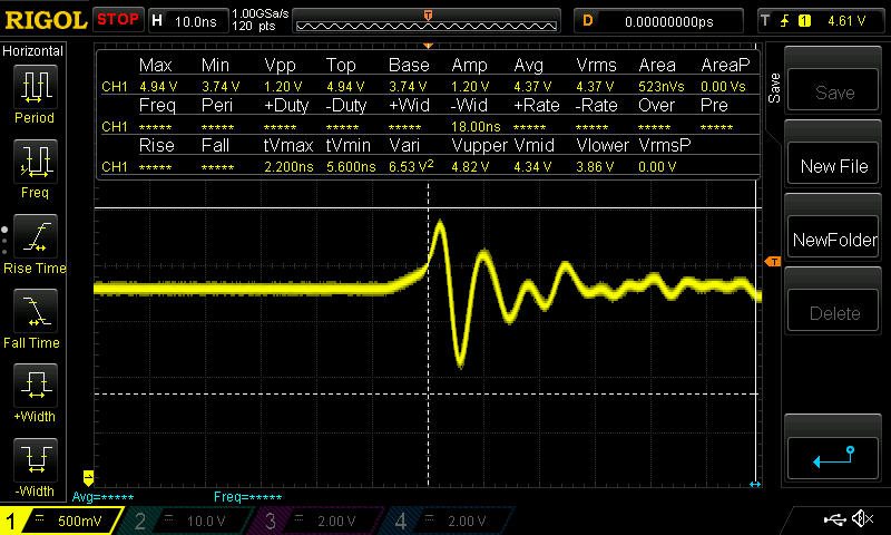

  • I'm testing with EVM, changing the components with my design but I have switch noise even at no load, and much more at 2A, I think this noise is not secure (1.20Vpp). ¿any advice? I'm testing with some capacitors but no success.
    No load 1uS
    No load 10nS
    2A load 10ns

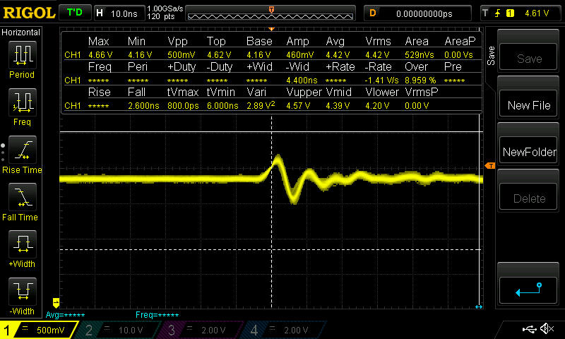

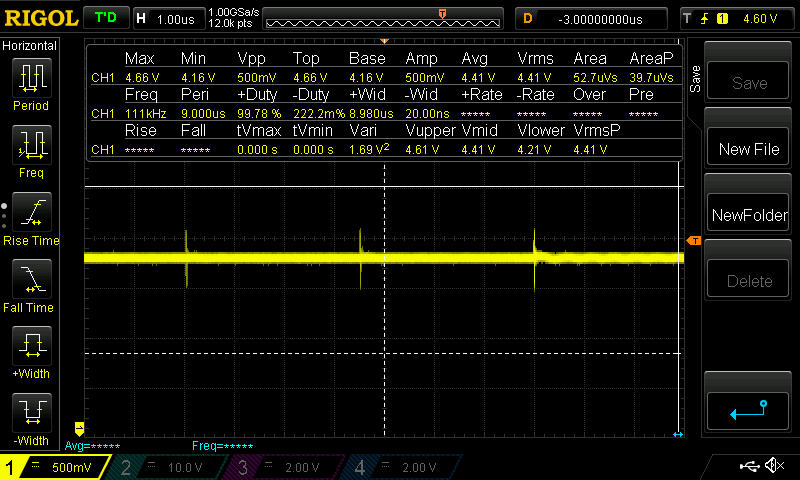

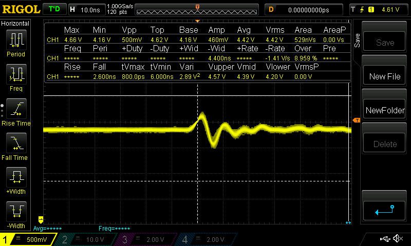

  • I've changed the electrolytic output capacitor for tantalum and now the noise ripple at 2A is 400mV, much better but still need an improve
  • If you use a 10Ohm (or start with 5Ohm) resistor on R8 to slow down the gate drive voltage, the ringing will be lowered. You could also consider snubber circuit from SW node to ground. Please note how you probe the switch node make a big difference as well. Use as small as possible ground loop for the probe to reduce the noise coupled through the probing loop.
