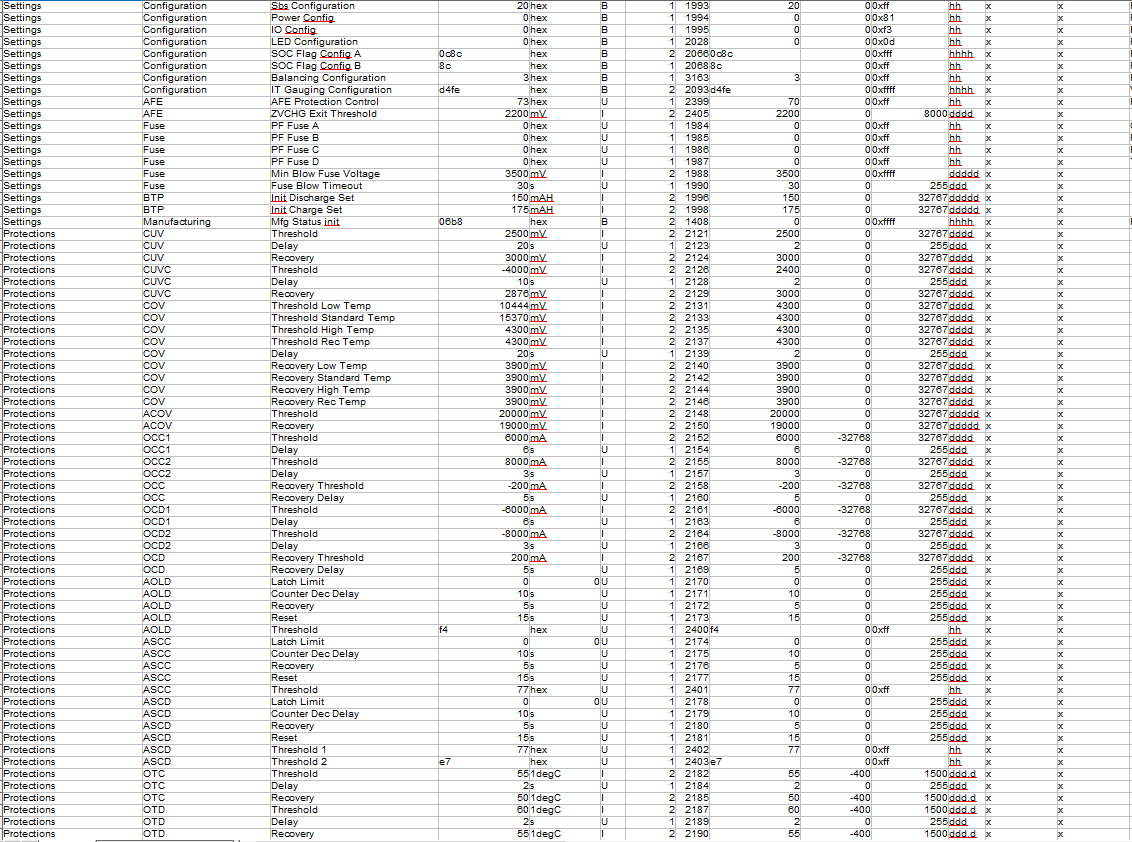

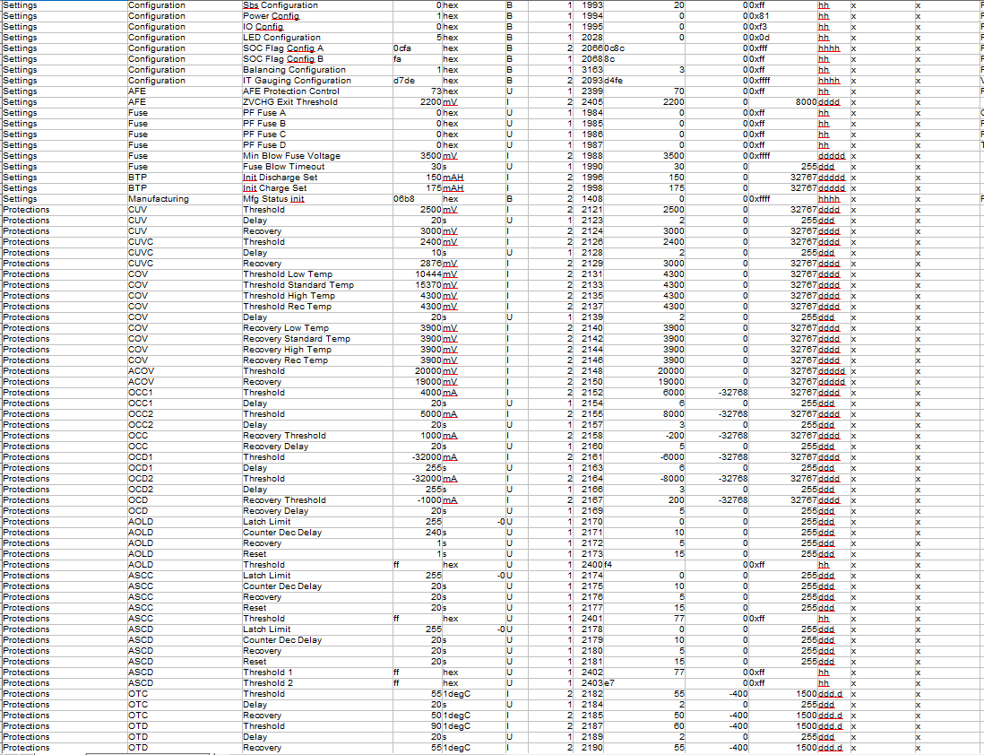

i am using a BQ40Z60 battery management chip in a custom circuit board to manage a 4S LiPo battery. A golden image .gg settings file has been made, and the settings perform well as configured.
However, after the device is sealed and sent to other users of the device, the settings change (not only the RA Table values and QMax values, but also the Protections Threshold settings and other main settings that change the behavior of the system.) My understanding is sealing the device should prevent these settings from changing until the device is again unsealed in Battery Management Studio.
Also, I have tried to change the Update Status setting to value "02" as mentioned in this post (https://e2e.ti.com/support/power_management/battery_management/f/180/t/427788),
