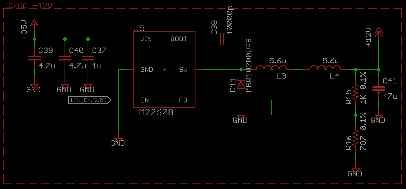

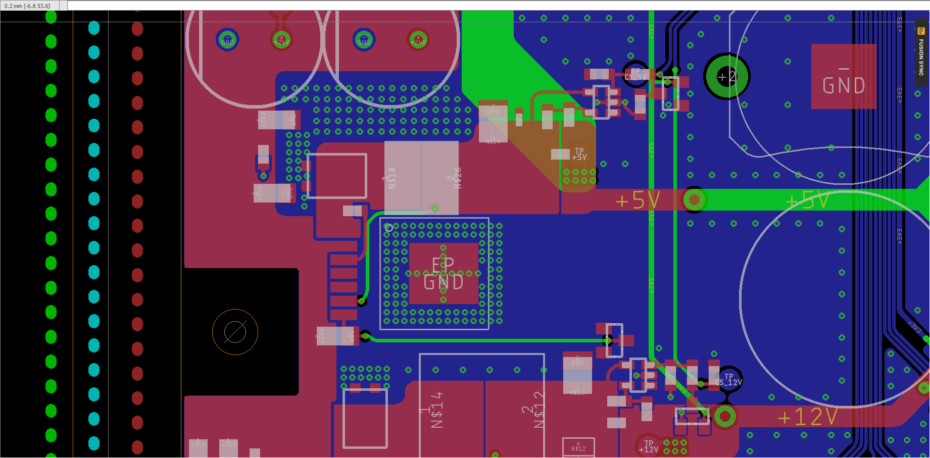

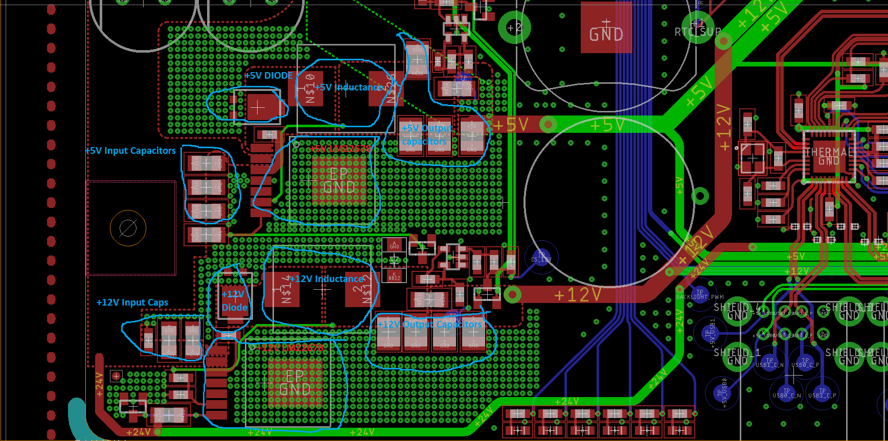

I am developing a board in which I will use 2 LM22678, one to provide +12V, the other one for +5V. You can find the schemes below, generated with Webench and implemented with Eagle CAD.
  • The input of the circuit is a 24VAC rectified and filtered through 8 x 680uF Electrolytic Capacitors, obtaining +35V. For the +5V DCDC, when the 35VDC switches off, there is a 10V battery pack (NI-MH) used to provide a soft-shutdown.
  • The diode in both the DCDC is a MBR10200UPS-TP.
  • The inductance is: ASPI-0630LR-5R6M-T15. In the 12V DCDC there is a series of 2 of these.
  • Except for the filter, the other capacitors are ceramics.
  • The enable input of the 5V DCDC is fixed high with a resistor and Zener diode. The 12V can be switched off by a microcontroller.

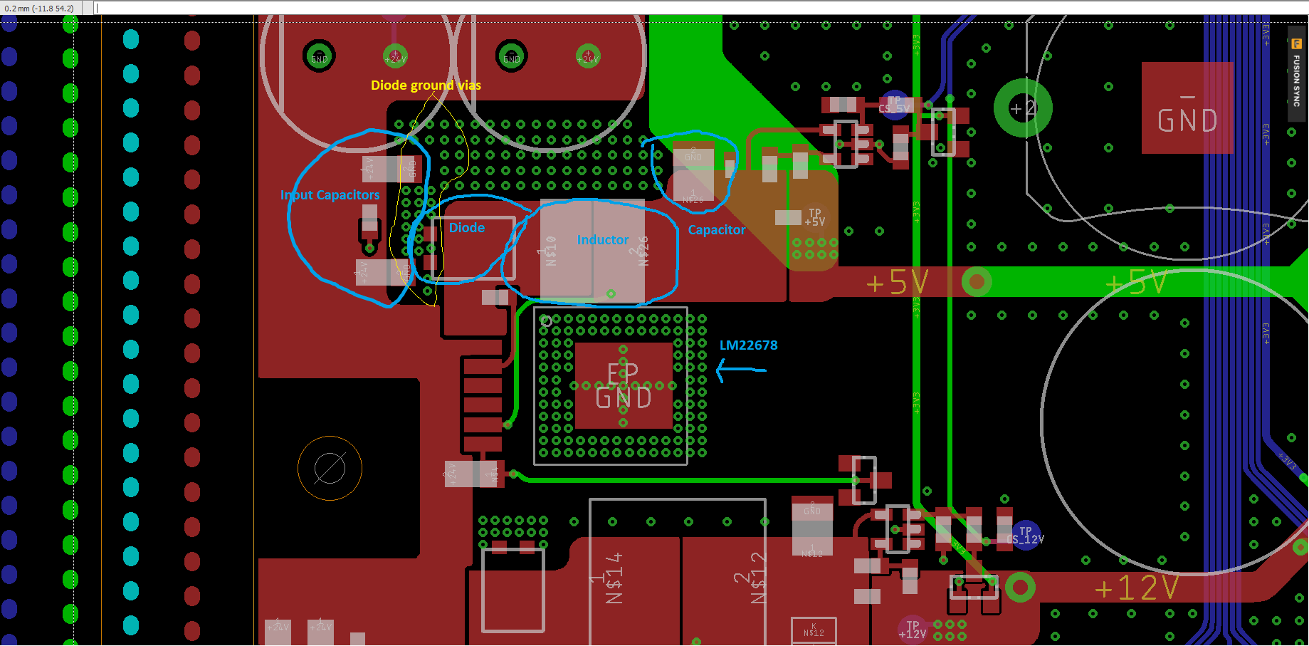

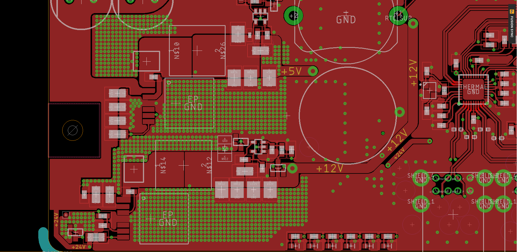

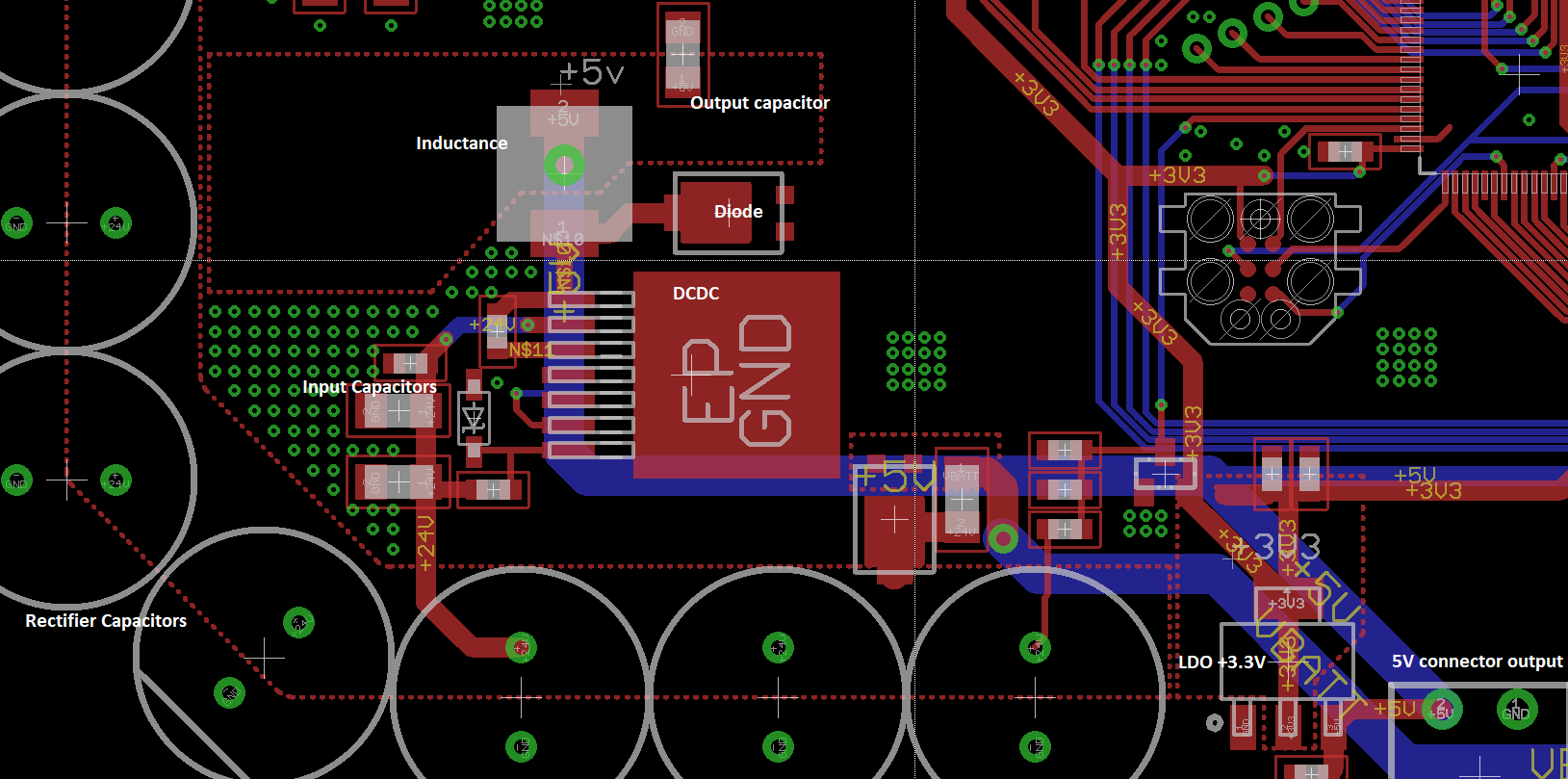

The layout of the DCDC that generates the +5V is attached below. The load of the 5V is a Display (0.8A), a Raspberry PI3 (0.7A) and an LDO (0.3A) that supplies a microcontroller (overall 1.8A).

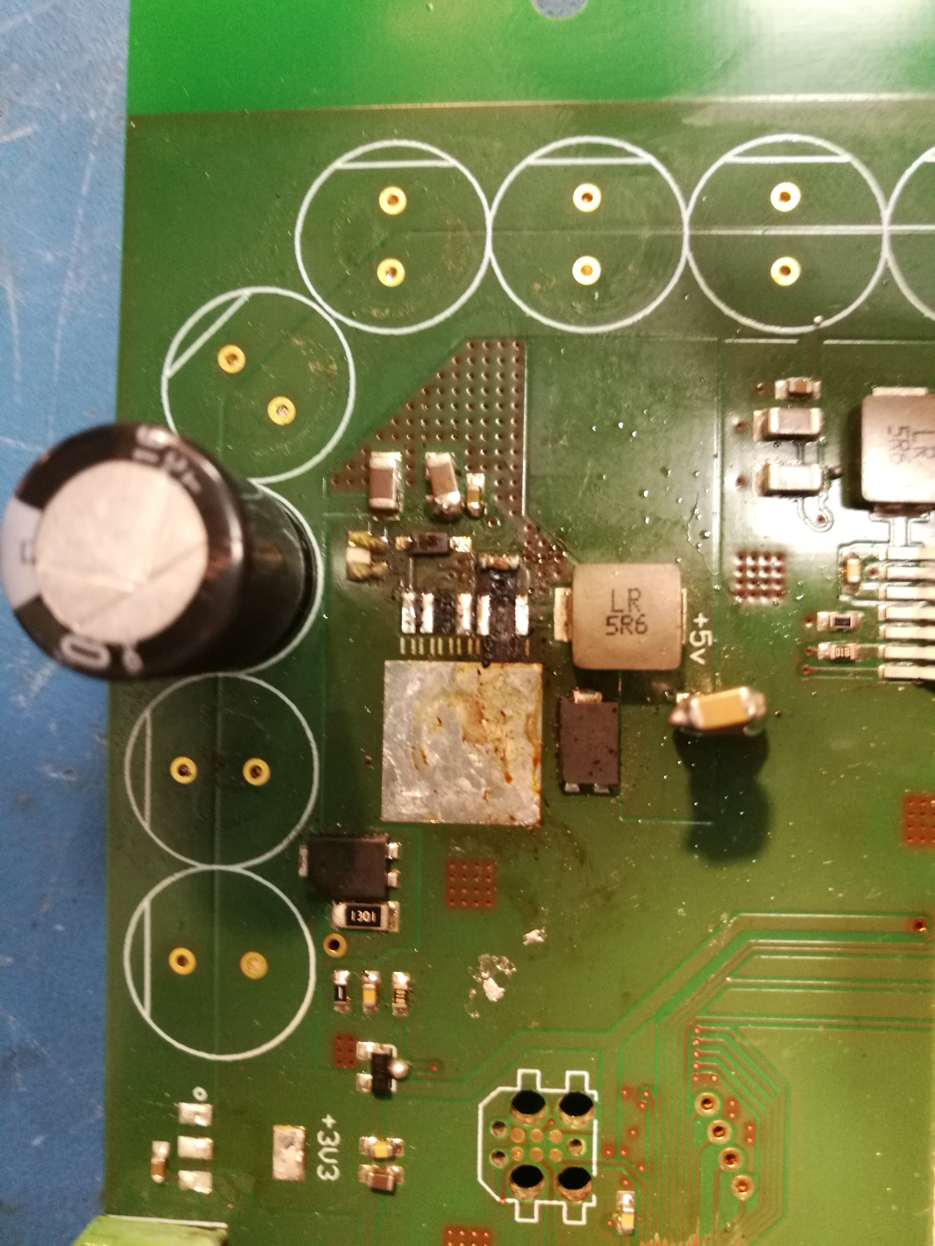

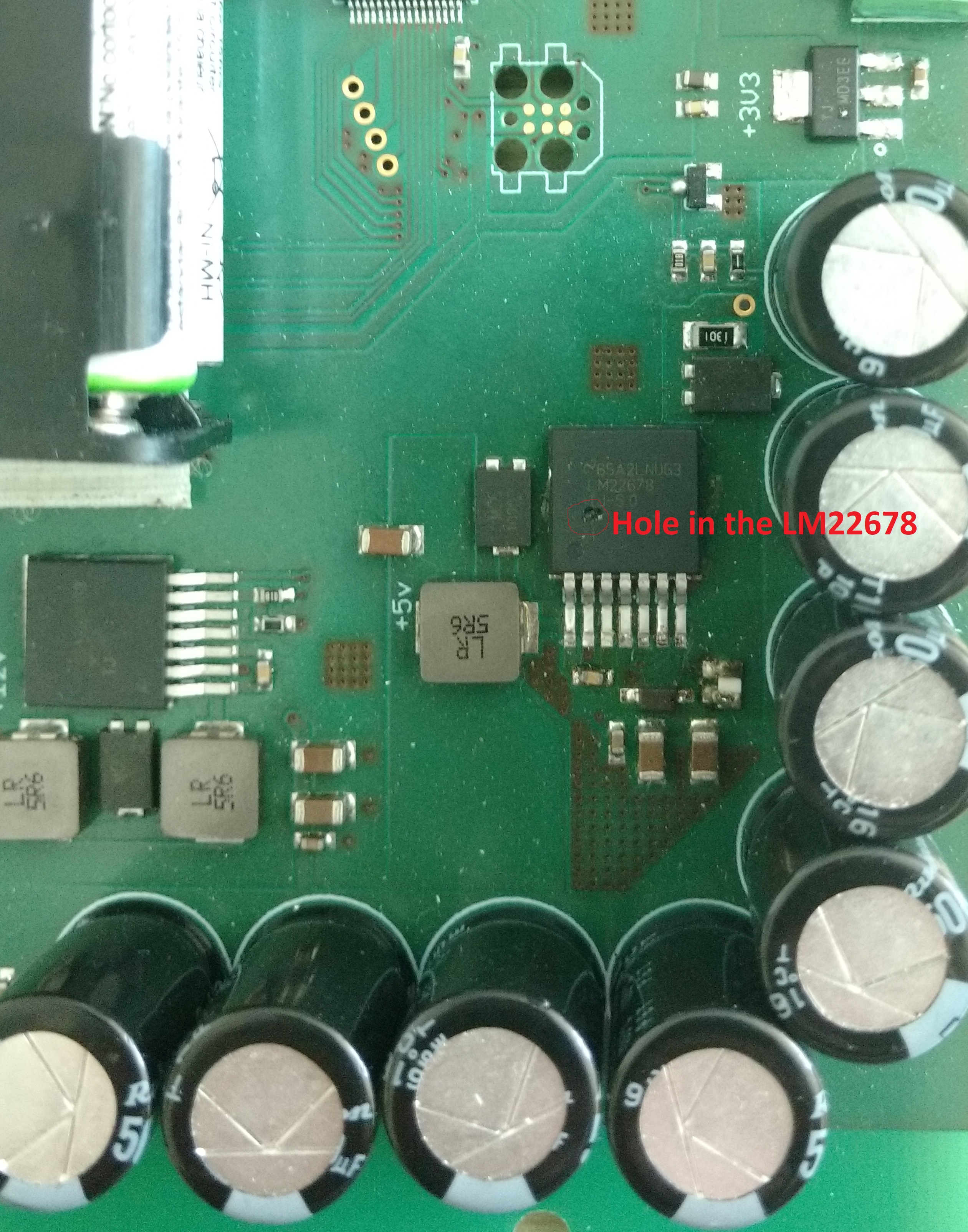

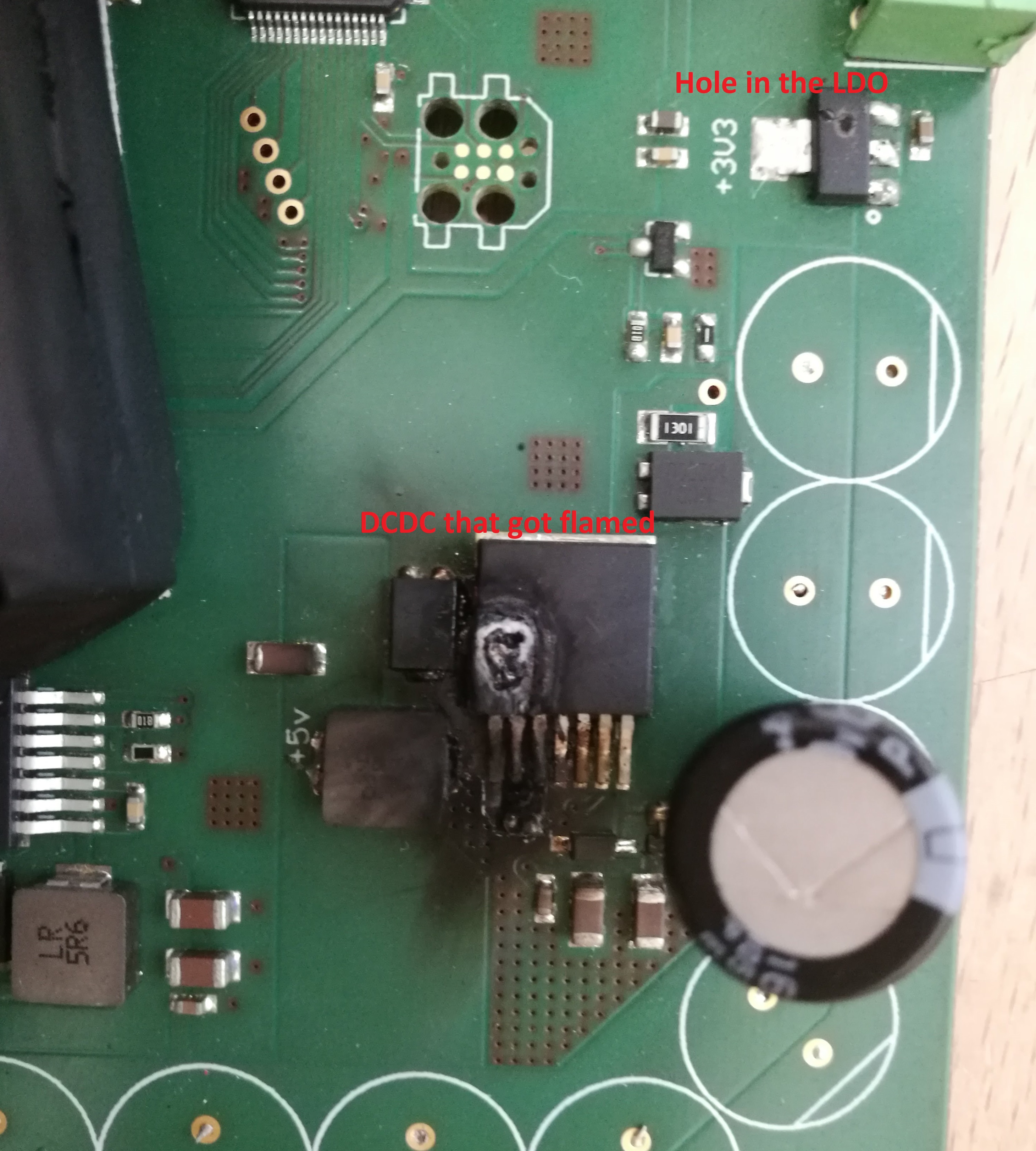

We have 7 prototypes that are in use since May 2017. The DCDC of the 12V never had failures, it works fine. The DCDC that generates the +5V, sometimes, sporadically, has failures. When it fails, also the LDO (TLV1117LV33DCYR) and the microcontroller fails.
The first hypothesis was that the problem was thermal, the DCDC in a box could reach 100°C (212°F). Stressing it, connecting a higher load (1.8A-2.0A, so overall 2.8-3A) to the display supply connector, the temperature grows to 130°C (266°F), and the DCDC goes in protection because of overtemperature. But seems not having any failures. I tried so to disconnect and reconnect this load to the board; the result was that the LM22678 got inflamed (usually, when there is the failure, the board just switches off, but I have never seen fire). So now my hypothesis is that changing the load can creates the failures. I think also the display can be considered a not constant load, and causing, after some time, the failure. The “high load” was connected and disconnected other times before the crash, so it does not happen immediately.
Do you have any idea of which can be the real cause of the failure? Do you have some tests to suggest?
Below there are photos of 3 failured board.
I can send you the components, 3xLM22678 and 2xTLV1117LV33DCYR in order to do a failure analysis. Is it possible?

    The type of failure described and shown on pictures attached is typical for over stress conditions.
    In all cases shown it appears that VIN pin on the device is damaged.
    This is only possible if there is significant input voltage overshoot present on VIn pin.

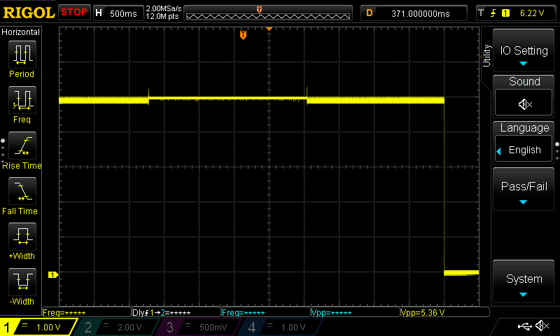

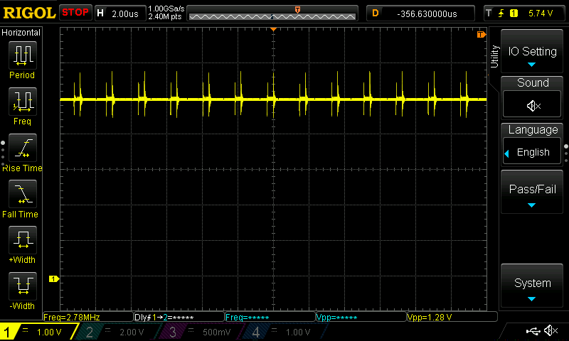

    I made some other tests. I disconnected all the loads and connected a 25W trimmer resistor to supply 2.6-2.8A. I connected it with long cables. I measured Vin (+35V) and Vout(+5V) both with all the electrolytic input capacitor (5440uF overall) and with only one electrolytic input capacitor (680uF overall). Usually it broke when the capacitors are all connected, but I tryed to removed them, just for the test.
    The preceding plots regard the test with all the capacitor (5.44mF overall). The voltages are the +35V and +5V supplies. You can see the ripple to increment when the load is connected and decrement when disconnected.
    The preceding plots regard the test with only 680uF capacitor for +35V and +5V. You can see that the ripple is much bigger on +35V. On the +5V there is some random noise. I tryed to switch on and off the load some times, and leave it on for some other time. After some seconds (30-50) it was on fire again.
    After that I noticed that the 100u output ceramic capacitor on the +5V line was much lower in capacitance (because it is X7R). So i added a lot of output ceramic capacitors (130uF effective overall) and made again the test with 680uF input capacitance. But it burned again. Before of that it restarted some times because of the overtemperature. You can see the plots below.
    In this case the plot start with the load connected, then the load was disconnected, after reconnected and then removed the supply. It is the +35V supply.
    This is a zoom on the 5V with load on. I think that noise is caused by the internal mosfet switching. I placed the oscilloscope's probe as close as possible to the dcdc.
    The input voltage seems good, not having overshoot. It should be strange that the problem is in the input voltage, because the other LM22678 that generates the +12V supply never broke.

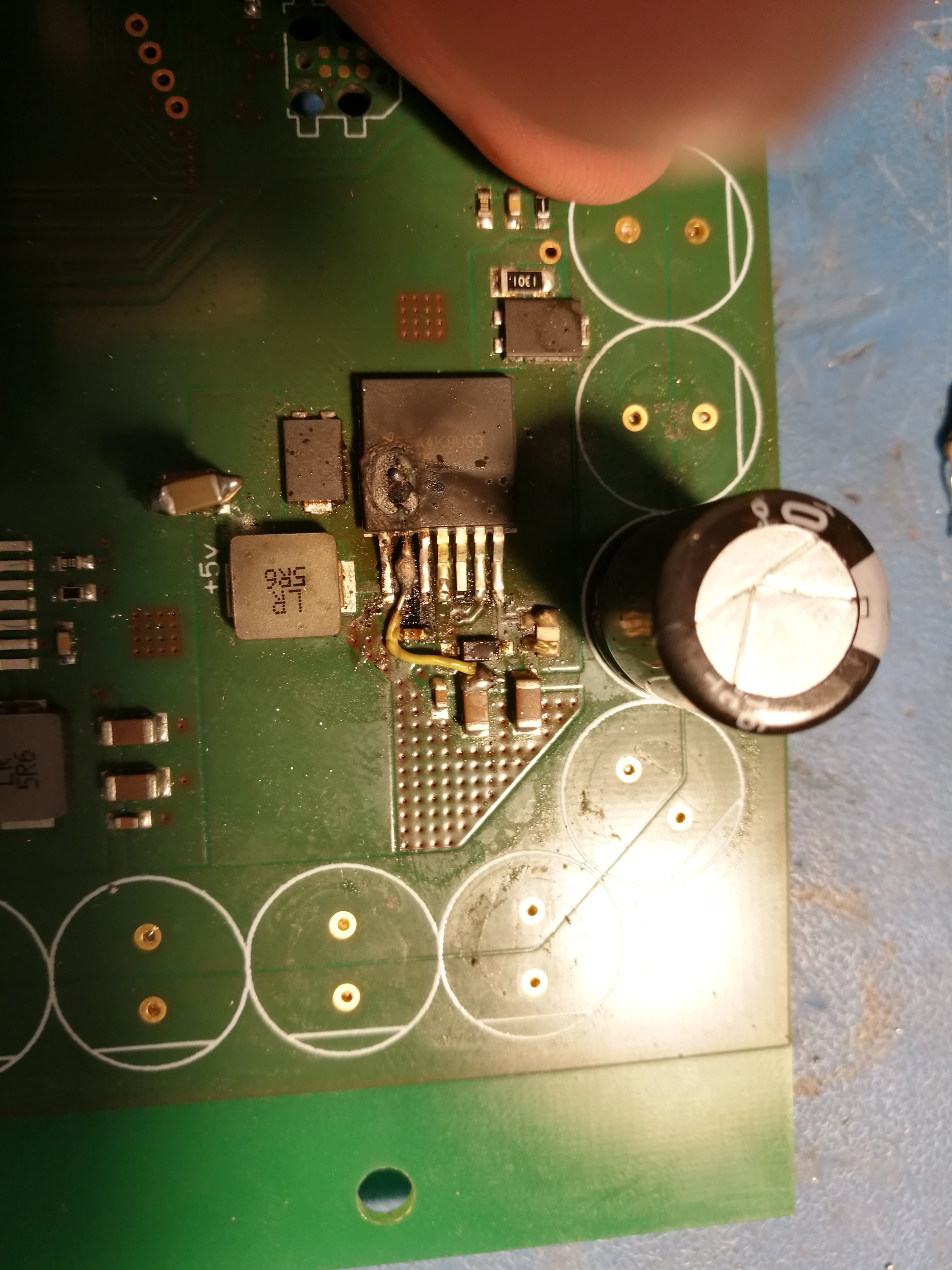

    The following photos are the taken after the second broke, the one with larger output capacitors.

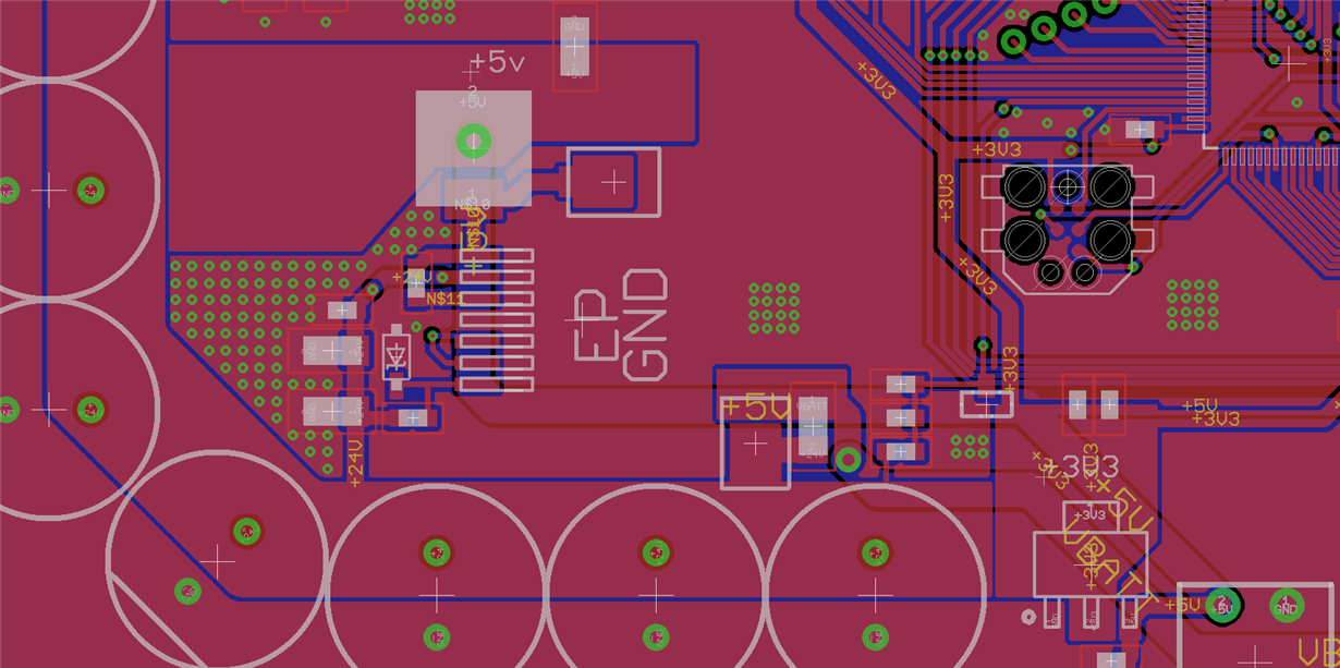

    In the second prototype i made a different routing for the DCDC. It is shown in the photos below. The PCB will be 4 layer. In the bottom layer and the second layer the ground planes are extended everywhere. In the third layer and in the top one they are big too. I left a rectangle out of the stop mask in the bottom of the circuit under the 2 DCDC, so it is possible to install an heatsink in the bottom.
    Do you think this will be a good way to have a good heat dissipation? Do you have any other suggestion for the layout?

  • Hello Lorenzo,
    The ideas proposed above were targeting most of the external components used in your design,so that the root cause could be identified.
    From your description it sounds like the issue could be related to thermal performance for 35 to 5V conversion circuit. Please see screenshot from device EVM regarding layout for optimal thermal performance. It is strongly recommended adding multiple thermal vias in the area of exposed pad on the IC as well as under re-circulation diode.
    Layout you are showing in the post above looks better that the initial PCB layout. However i think it would be beneficial to have more vias in the exposed pad of the IC and also on the diode. As much as i can see there are no thermal vias underneath diode. We are also recommending to select diode with exposed pad for improved thermal performance. Having solid copper pour on top and bottom layer will help with heat dissipation.
    In the layout are providing i don't see any input capacitor near the IC. It is extremely important that at least small bypass capacitor (100 nF or similar) is placed close to the pins on the IC that should be decoupled (in this case between pins 2 & 4). Large pulsing current is going through Vin/GDN pins and proper decoupling is very important for proper functionality.
    Have you manufactured new board or there is till a chance to make some layout changes? if you can make changes please provide layout file for review and comments.At this point i feel like we need to verify device performance with improved layout in order to make any conclusion as root cause is concerned,

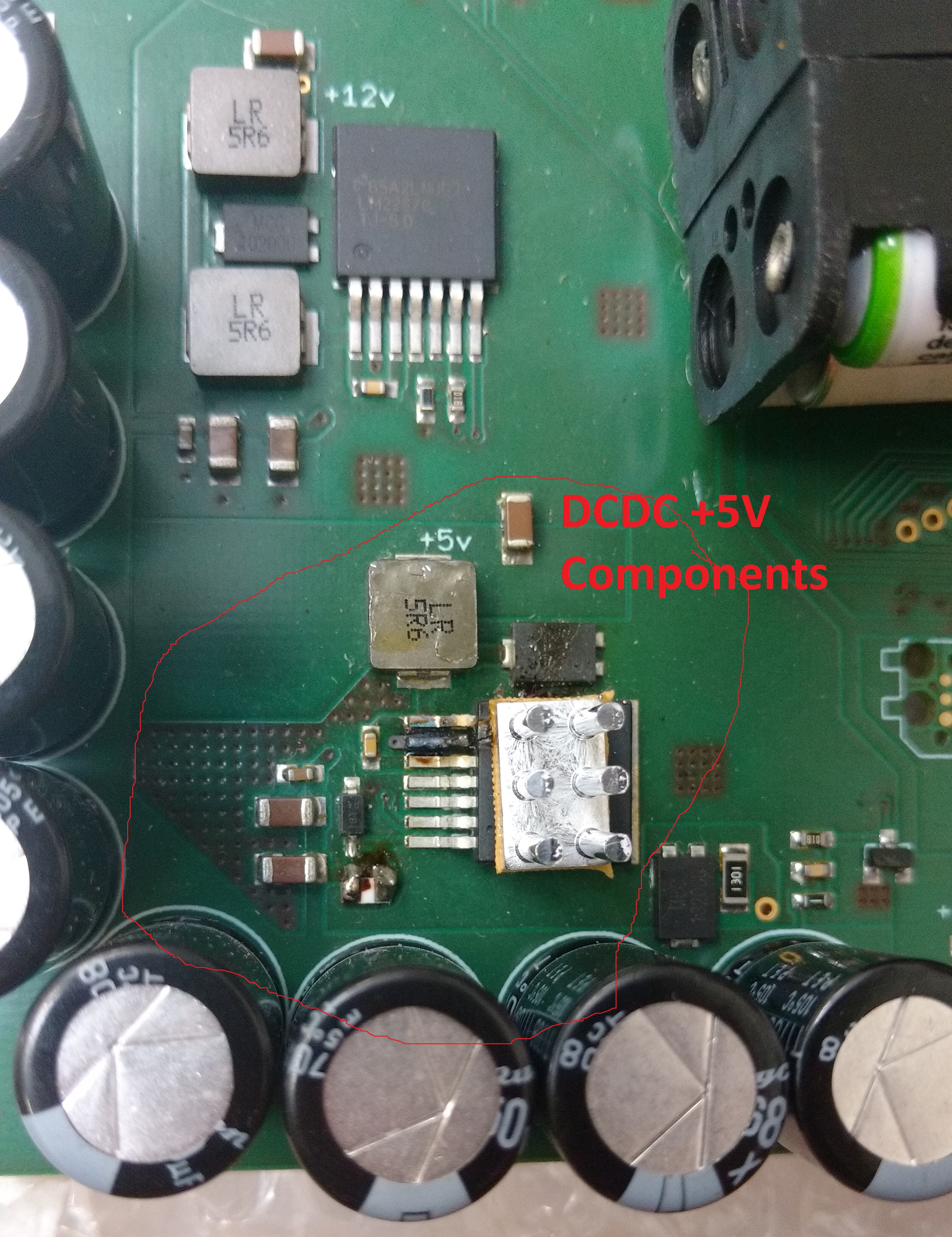

  • Hello Brani,
    I repost the previous photo adding some details. I highlighted:
    - The input capacitors, do you think that in that position they are too far from the DCDC? They are 10uF overall.
    - The ground vias of the diode. The ground pins are the 2 highlighted near the via. Do you think there are not enought via?
    The first 3 board are manufactured. Tomorrow I will add all the components and start some tests. The board can of course be modified before be produced in big quantities. I think i could move right the diode and the inductor for have more ground plane near the diode and move down the input capacitors. I can send you some photos when I will finish the last version.
    About the vias under the LM22678 thermal pad: if the are a lot of via under it, can the stagnum pour into them, creating some soldering problem to the component? If you think that this cannot create problems, I of course can add vias on all the thermal pad area.
    Thank you for the support!
    Lorenzo

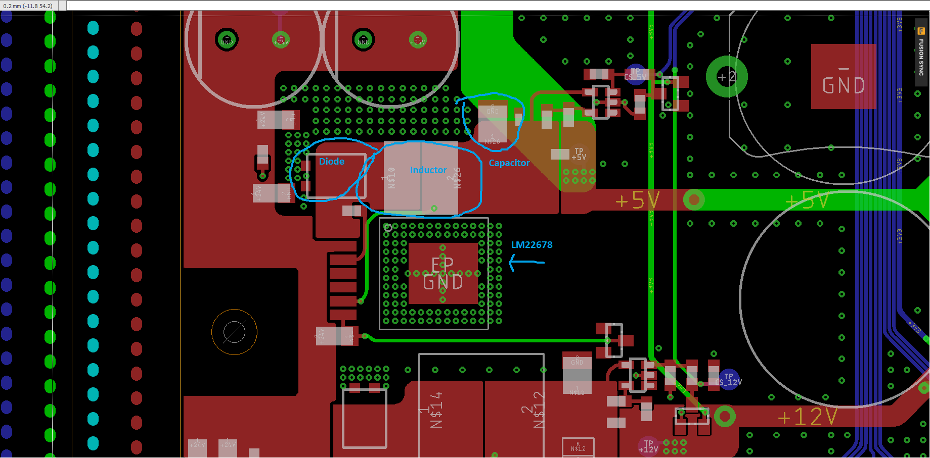

  • Hi Lorenzo,
    Thank you for this layout screenshot.
    It certainly looks better, however i have some recommendations:
    1. Input capacitor is too far away form the IC pins. If possible place small bypass capacitor (47 or 100nF) very close to the pins that it suppose to decouple (2 & 4).

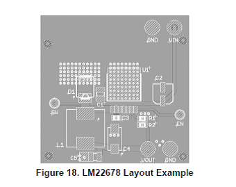

    2. For best results i strongly suggest to try to replicate layout on the device EVM. This is proven and tested layout which should allow you to move faster with your design solution with minimum number of corrections needed.
    3. Regarding thermal vias in ground pad: Feel free to add some more vias in the exposed pad. You are currently showing sibgle horizontal and vertical row of vias. I would suggest to minimum double or triple number of vias in x/y direction.

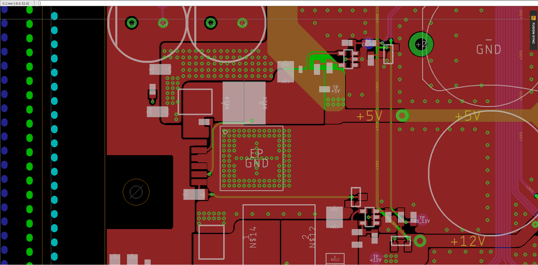

  • Hi Brani,

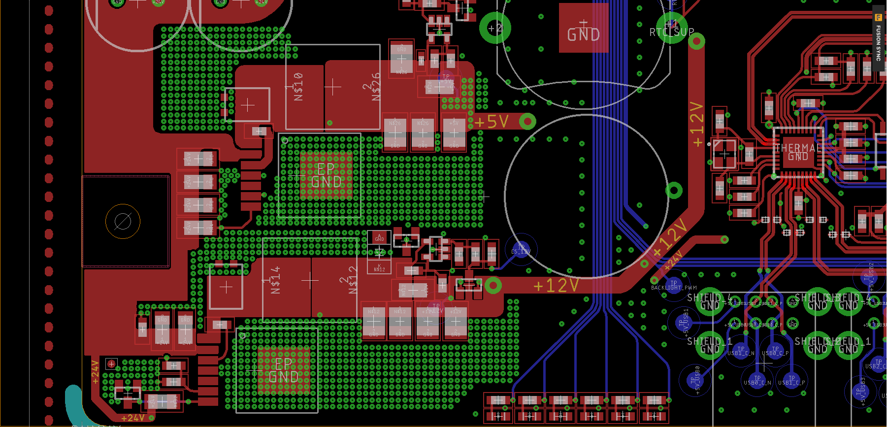

    I tryed to replicate as similar al possible the scheme, but the input and output direction added difficulty. These are the photos:
    Without planes, all layers
    Top with plane
    Top and bottom with all planes except ground plane.
    The ground planes are in all the 4 layers, the input capacitance are nearer to the input pins, the 5V inductance is bigger (10uH), and I added some output capacitors 1210 (130uF for 5V, 47uF for 12V). I added a lot of vias.
    What do ou think about it?
    Kind regards
    Lorenzo
  • Hi Lorenzo,
    I think this layout looks much better.
    However i have couple of suggestion:
    1. Swap position of 5V inductor and circulation diode. this will allow for much tighter ground loop between input and output
    2. make sure your input power supply is not hitting current limit. The reason for this is that you see big ripple on input when load is applied . This indicate that your input power supply might be hitting current limit.
    Other than this layout looks much better.
