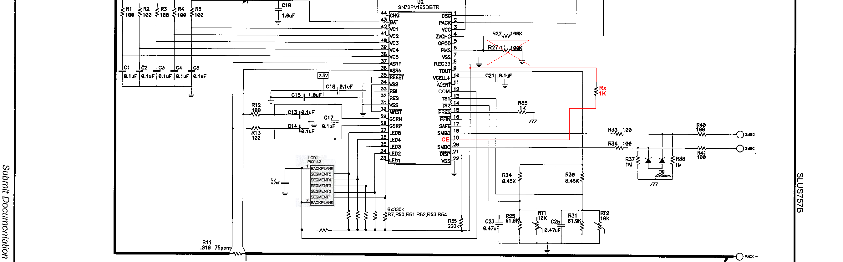

As it comes to my understanding SN72PV195 is replaced by bq20z95. I controlled the datasheets and saw two differences. COM pin (12) and CE pin (19) has changed to NC.
Since bq20z95 is almost a pin to pin replacement I tried to use it with my old circuit. But I'm having some troubles. LCD is not working anymore and current register (0x0a) always indicates 0 amps. When I draw some current from the circuit its value does not change. Hence OVP is not working.

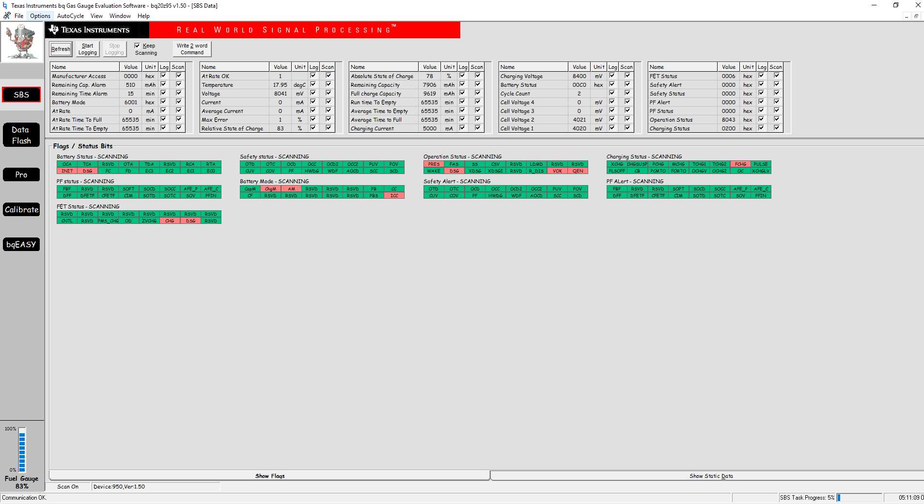

  • We resolved the current issue with calibration.
    But we are still having trouble with the LCD. When we connect the circuit to bqstudio the 5-digit LCD bar graph we use, starts count 5 to 1 and repeats. It does not display the SoC of the pack as it should be. When we remove the SMBus connection all bars on the LCD are on, after around 10 seconds all of the bars start to fade and all gone. Can you help with that?

  • Hello Bryan,
    Schematic of our circuit and status files that we are using with bq20z95 are in below. We checked LED blink rate, flash rate, delay, hold time and display format. We did not saw any problems. I've tried following Operation CfgA codes;
    0x0D21, 0xED01 and many others. And the display continued not to work.
    And we also noticed that bq20z95 does not give any information about LCD support, but SN72PV195's datasheet were containing information about LCD support.

  • Hi InProgress,
    Thank you for sending the schematic and view of your status registers. Please send a log of the event and the settings of your dataflash for further analysis.
