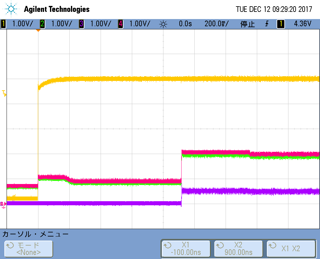

Can TPS54531 start up under pre-bias situation?
TPS54531 can't start up in my customer situation.
Vin=5V -> Vout=3.3V.
Issue case is start-up from "Vin=0, Vout=600mV".

    TPS54531 is a Non-sync buck converter, it can start up with pre-bias condition as no inductor reverse current, can you upload more detail application circuit?

    Below is waveform.
    Do you have a idea of cause?
    CH1 : Yellow Input voltage
    CH2 : Green Output voltage
    CH3 : Purple SS pin voltage
    CH4: Red PH pin voltage
