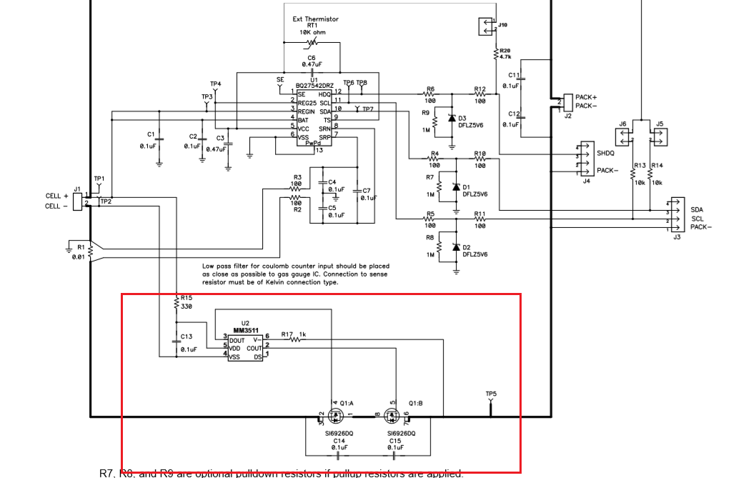

    and in three of them the protection ic is common so if I'm using the BQ24195 so is there need of protection ic and that mosfet.

  •  Hello sir,
    Protection ic is used in BQ27542 so If I'm using the BQ24195 so is there need of protection ic and that mosfets.
    please help
    thank you in advance..
    The protections built-in onto the charger are secondary protections, it's still assumed a primary protection IC is used in the application.I recommend using a primary protection IC with external CHG/DSG FETs. Primary protection offers additional protection when charging Li-ion as well as faster response time when compared to secondary protection.
