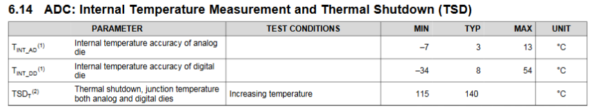

My customer's battery manage system uses bq76pl455a,Customer want to know about the accuracy of internal temperature sensor:
1、The maximum  Tint_dd is 54℃。
2、The minimum  Tsd is 115℃。
3、If ambient temperature is 65 ℃,and The Tint_dd temperature error just for 54℃ ,Now if BQ76PL455A enter protective state or not?
