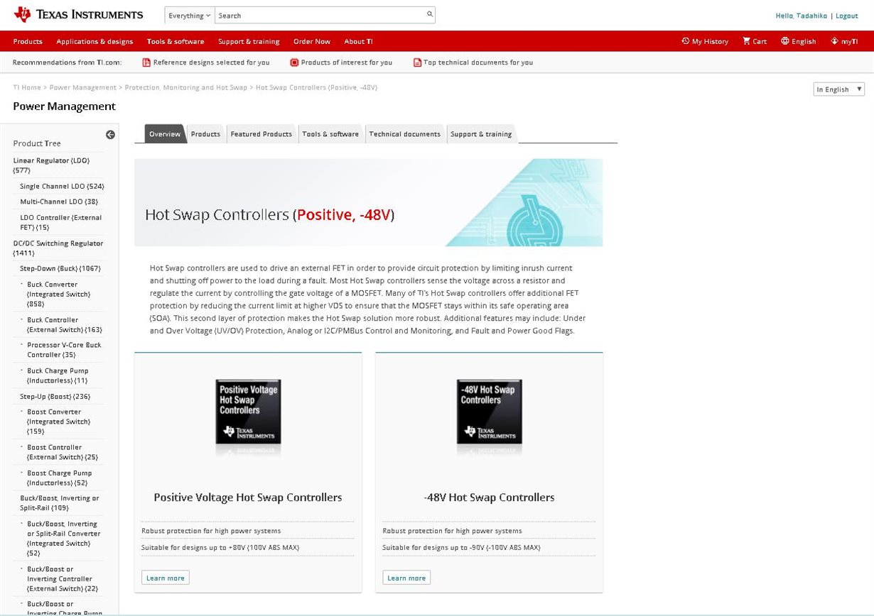

    > Go to www.ti.com/hotswap to download the latest design calculator tool
    I couldn't find the calculator tool on above URL...
    Is it exist on the below screenshot?
    Kuramochi
  • Kuramochi,
    Place the capacitor at the positive side of the resistor (current entering resistor), right at the pad.  This filters both sides of the resistor and prevents DM signal from triggering current protection and also prevents Vin - Vsns from exceeding the device rating of +/- 0.3v.  See figure 43 and the abs max table for further explanation.
    The calculator tool is under the "Tools and Software" tab.
