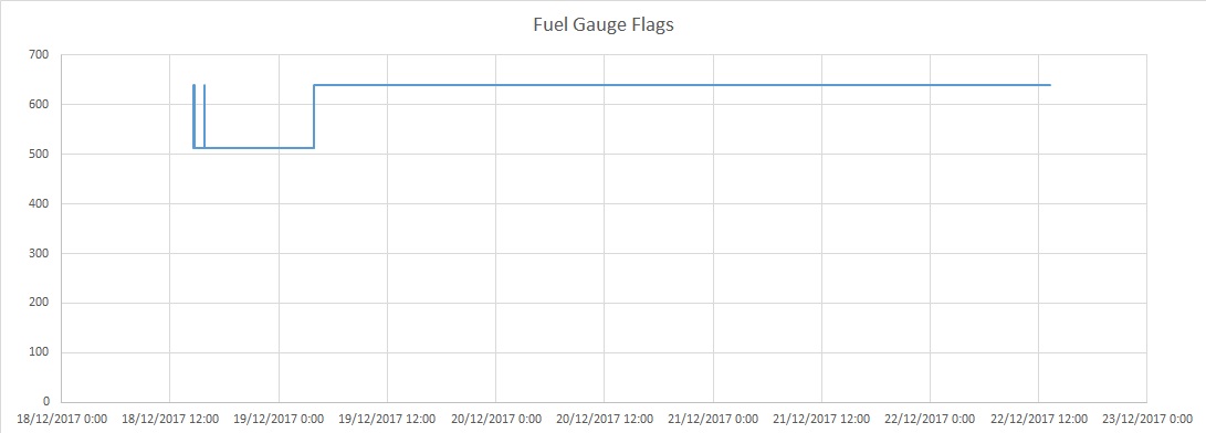

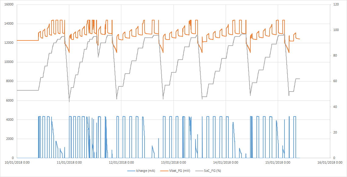

  • Hello Bryan,
    We have done some extensive testing in order to determine if and when the BQ34Z110 performs QMAX updates. Right now we have a test running where the battery is cycling between charge and discharge.
    During the charging step we added a periodic cutoff from the battery where the charging is stopped and the battery voltage is allowed to relax. The current parameters are: 1 hour charge, 2 hour cutoff. This is visible on the following plot:
    However, we see that the battery voltage is still stabilizing even after 2 hours.
    The parameters for the fuel gauge are as follows:
    [Current Thresholds(Gas Gauging)]
    Dsg Current Threshold = 20mA
    Chg Current Threshold = 25mA
    Quit Current = 13mA
    Dsg Relax Time = 60s
    Chg Relax Time = 60s
    Quit Relax Time = 1s
    Cell Max IR Correct = 400mV
    We're also monitoring the various registers and logging every change in the fuel gauge flags and FCC. From this we can see that FCC changes very minimally and the fuel gauge flags indicate that OCVTAKEN bit is always low so an OCV measurement is never performed.
    I assume this has something to do with the requirement that dV/dt < 4 μV/s for the BQ34Z110 to perform a QMAX update, but this is something we can not change.
    I don't see how we are supposed to ever take OCV measurements in a practical way. Are we doing something wrong or is this normal?
    Kind regards,
    Sammy
  • Hi Sammy,
    Thank you for this clear image and description.
    For a Qmax update, OCVTAKEN should assert when the battery relaxes and and OCV value is measured with enough DOD between two OCV measurements.  In the above image, I do not see the battery relaxing at different depths of discharge, a requirement for a QMAX update.
    Please attach your log and your gg.csv file so I may analyze your settings and corresponding results.
    Sincerely,
    Bryan Kahler

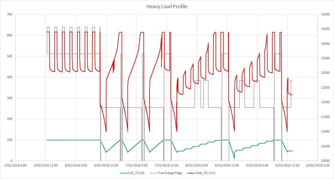

    The log is also attached here. You'll see a lot of system parameters, but basically all the parameters with _FG in the name are from the fuel gauge. We've also added the RCON register, FCC and fuel gauge flags registers. A periodic log is taken every 100 seconds or whenever there is a state change or certain parameters change. For example if the fuel gauge flags change it'll also write a log.
    high_power_log_ti.xlsx
    You mean the battery voltage never fully relaxes? We are trying to relax the battery periodically as you can see this does happen at different DOD's (gray plot = SOC) but only during the charging cycle. It's practically impossible for us to relax during discharge as the system functions as a UPS.
    In the mean time we're running a test with the Fast Qmax enabled. You'll see that it's actually disabled in the gg file I've attached. So I made a new gg file with this bit enabled. I'm having some trouble finding a clear description of the fast qmax behaviour. I've found some descriptions online for a different fuel gauge, but the parameters do not match 1:1 for our fuel gauge.
    As far as I can see there's only three parameters:
    Fast Qmax Start DOD % = 92
    Fast Qmax End DOD % = 96
    Fast Qmax Start Volt Delta = 100
    The behaviour as I understand it now is roughly as follows:
    • the fuel gauge will perform a fast qmax measurement at full charge
    • the fuel gauge will perform fast qmax measurements when the DOD is between 92 and 96% or the battery voltage is lower than the termination voltage + fast qmax start volt delta (100)
    This second situation will never actually occur in our system as normally we would never discharge the battery that far. So I have started one test with the defaults (92% and 96% DOD), but with deeper discharge than normal. Just to see if any qmax updates are done at all.
    In the other test I've changed the start DOD % to an extreme value (50%). I realise this will probably result in incorrect measurements, but right now we're getting no qmax updates at all so I wanted to see if there is any way we could force qmax updates.
    I appreciate the help as this a really important issue for us. We need to get a SOH and SOC reading that is at least somewhat reliable.

    Here's what I'm seeing in the log where we had an OCVTAKEN:
    So at the start you see some toggling of the flag which seems to indicate OCV measurements are performed (it changes from 640 to 512 decimal, so bit 7 is toggled = 128). But after that it stays low for a very long time (about 12 hours) which means the fuel gauge is now in relax mode. Only 12 hours later we get an OCVTAKEN and then the fuel gauge never goes back to relaxation mode.

    We have seen the OCVTAKEN flag getting set, but only after a very long relax time and after it gets set it never gets toggled again (not sure if this is normal?). I have included an example log where the OCVTAKEN flag gets set (note this a few days after entering relax mode).
    log_ocv_toggled.xlsx
    In the following graph you can see the current is zero, so the fuel gauge should be in relax mode. OCVTAKEN flag is also low, which confirms this.
    It appears there is still some variation on the battery voltage (about 40mV in one day at the middle of the graph). The datasheet mentions:

    We did some more testing. First of all I want to mention we have now send the command ITENABLE and we're seeing some OCV measurements being made. In the previous tests we had not send this command so that might have been the issue...
    In any case, as before I have two tests running. Both are cycling between charge and discharge.
    • one with a conservative load and a (very) conservative SOC cutoff at 40% --> does not qualify as 90% DOD, just used to check if OCV measurements are being made
    • the other with a heavy load and cutoff at 5% --> this one should qualify as a 90% DOD
    In both cases I have added a periodic relax time during the charging cycle to allow the FG to perform OCV measurements. I am seeing sporadic toggles of the OCVTAKEN flag which seems to indicate it's working. However, I am unable to go down to a DOD of 90% as you suggest because the SOC value seems to be incorrect. In addition to the cutoff at 40%/5% we also have a cutoff if the battery reaches 10.8V to prevent deep discharge. The SOC at that point is still higher than 10% so we're not getting the full range. Maybe this is because the batteries are a bit older? We have cycled these pretty much non-stop for a couple of months so maybe that's why the SOC is wrong?
    I have included both log files as well.
    2402.logs.zip
    I expected the OCV measurements to "nudge" the SOC back to the correct position, but this does not seem to be the case. Note that we have also increased or charge voltages from 13.8V to 14.4V on request from the customer. Could this have an impact on the SOC measurement?
