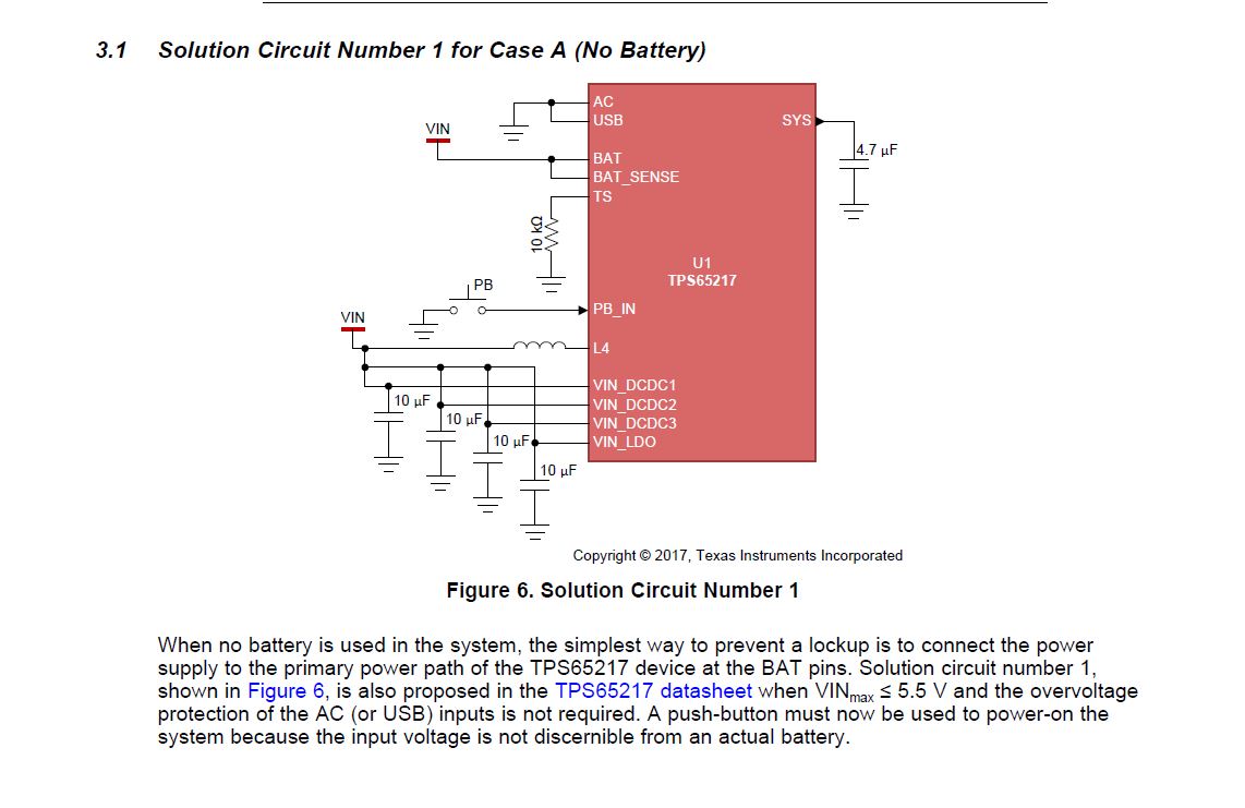

  • Nick,
    If I do decide to power the system through the BAT pins of TPS65217 as shown here from app note SLVA901, why does the suggested schematic not take the output SYS
    to the inputs of the LDOs and DCDCs as is normally the case? Are both options acceptable?
  • Daniel,
    I am not sure why this schematic uses VIN for the inputs instead of SYS. I have notified our device expert for the TPS65217 so he can help answer your question.
    Thank you,
    Nick
  • Daniel,
    Solution circuit #1 is an adaptation of the circuit on page 77 of the TPS65217 datasheet, on the right-hand side of Figure 56.
    If there is only 1 form of power being used to operate the PMIC, where this source is NOT a battery and <5V, then the Power Path is unnecessary. As a result, all downstream rails (DC-DCs and LDOs) would be better off accepting power directly from VIN.
    This is an ideal workaround to avoid issues that some customers experience when using the Power Path without a battery. The schematic is usually copied from the Beagle Bone Black reference design and the PMIC is left as-is, and the lack of close examination of the PMIC schematic often leads to the lock-up.
