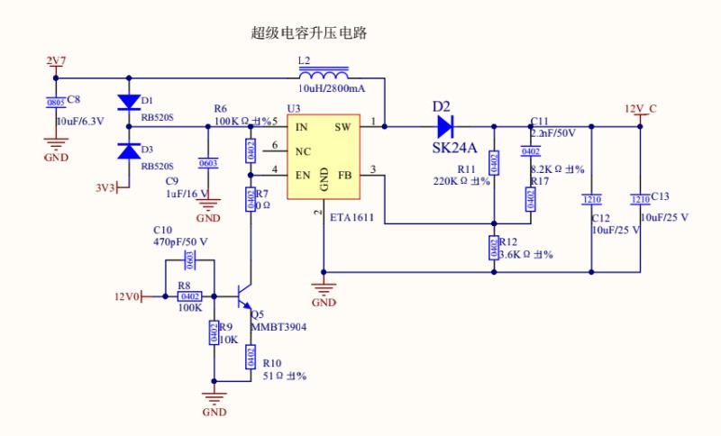

Hi Team,
My customer now is looking for Super cap boost to 12V/200mA solution. And now ETA already give them their solution as below:
1. Input request is 2.7V from super cap;
2. Out request is, 12V Iload=200mA;
3. Low cost;
We found that LM2623 may be one solution, but need your help to check if it is ok and if you can share with me a reference circuit for this request? Another question is for the output cap, can customer just use ceramic capacitor for lower cost?
Sulyn Zhang
  • Hi Sulyn,
    What is the minimum input voltage?
    I use webench and find TPS61086 is a good choice and customer can use ceramic capacitors as the output caps.
    LM2623 has no webench models now. I'll look at it if you prefer to choose LM2623.
    Zack
  • Hi Zack,
    Thanks for the support! Agree that the TPS61086 may be a good choice, the minimum voltage may low to 1.8/1.6V, but it's better than ETA part. I will check with customer about this and let you know the prefer, thanks!
    Sulyn Zhang
