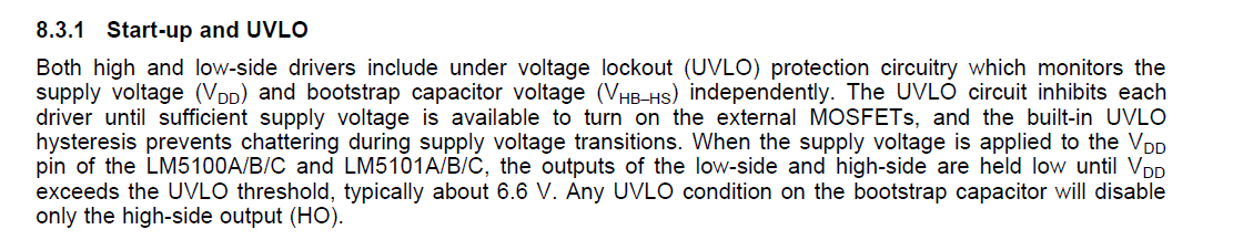

    You are facing above issue as bootstrap capacitor voltage(VHB-VHS) is less than device's Boot-UVLO (6.6V).
    Below is the description from Datasheet about device's UVLO.

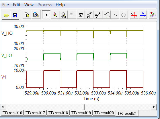

    The model worked properly when I decreased the voltage at HS to 5V from 30V(Below is the simulation result).
    If you need HS voltage to be 30V then try to apply a VDD>37V.(PFA tsc file for your reference)snom359_18DEC.tsc

  • Sorry! As images are missing in above Post
    Datasheet Description:
    Simulation Result:

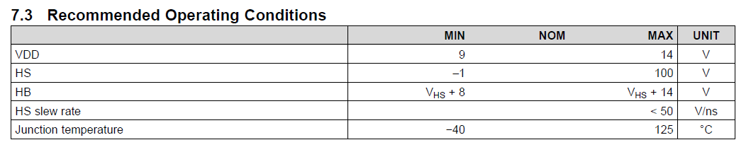

  • Hi Prashant,
    Yes, the VHB-VHS should be greater than 6.6V in order to meet UVLO recommendations.
    Below are the couple of snapshots from datasheet which confirms this.

  • Hi Prashant,
    In case of buck converter the VHS node will be a switching waveform and you have applied a 30V fixed voltage at it.
    I applied a switching waveform at this node and results seems to be as per your above explanation.
    PFA tsc file and simulation results.
