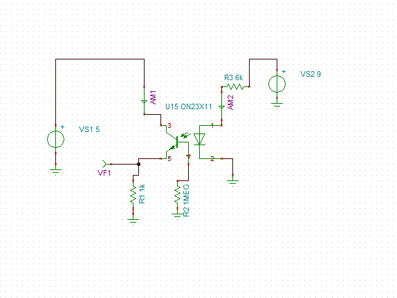

what is the exact part no of the model being used (ON23x11)?

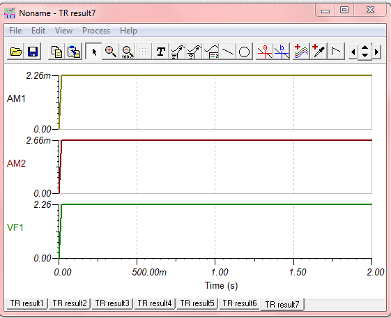

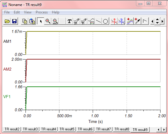

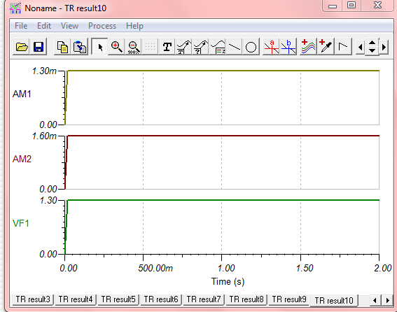

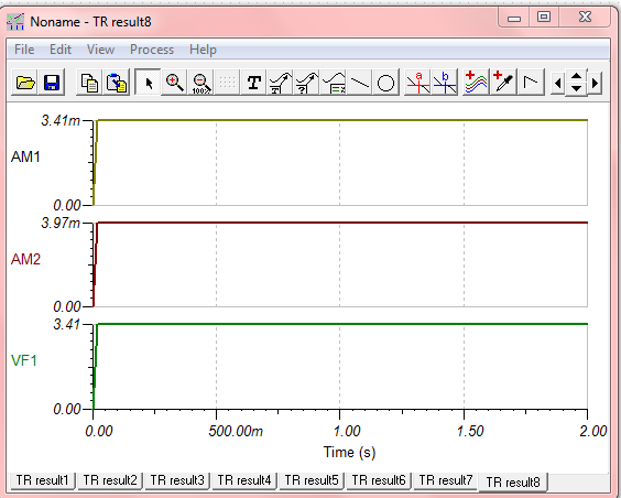

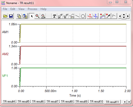

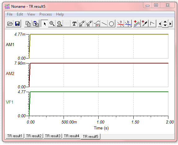

i tried observing the behavior of the this model by test circuit and results attached for different values of R3. I Observed different CTR .
For R3=1k  CTR=0.6
      R3=2K CTR=0.859
      R3=3K CTR=0.849
      R3=4K CTR=0.83
      R3=5K CTR=0.81
SO is that CTR Is function of diode current?
any other model of OPTOCOUPLER / PHOTO-TRANSISTOR  is available? and exact part no the device?
thanks,
samrat
      R3=6K CTR=0.79

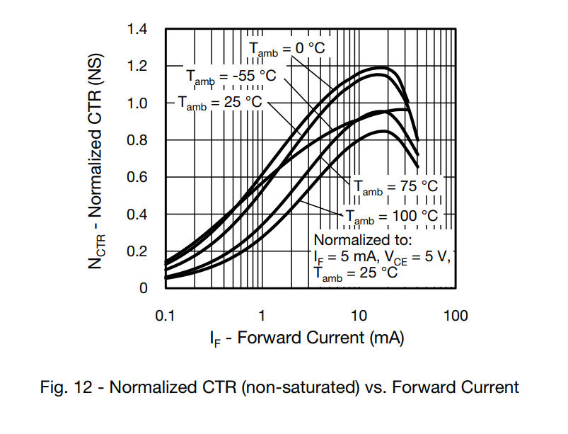

  • Hi Samrat,
    Thanks for your interest in UCC2895. CTR is dependent on the forward current in the LED. Here is an example CTR vs forward current normalized to If = 5mA.
    I would suggest taking a look at the TINA model for LM5046. The model includes a symbol for PS2501 optocoupler.
