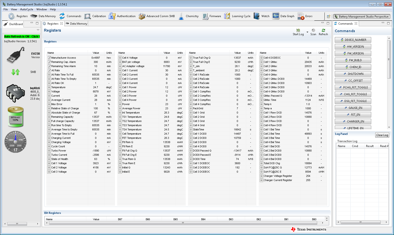

Can cell balancing be done during Constant Current (CC) mode or during Constant Voltage (CV) only?
What is the most voltage difference that can be balanced in one charge cycle?
Cell Balancing seemed to be enabled but the bq40z60 did not balance the cells and went into a fault condition at Full Charge.
Senario:
Cell Balancing was enabled by going below 10% RSOC then Resting.
DisCharged to:
RSOC = 3%
Cell 1 =  3343 mV
Cell 2 =  3562 mV
12VDC (AC Input) was applied and charging started.
CB = 1, Cell Balancing = Active
Cell 2 Bal Time = 65535 seconds
Full Charge was reached without going into Constant Voltage mode.
Cell 1 Max Voltage = 4040 mV
Cell 2 Max Voltage = 4300 mV

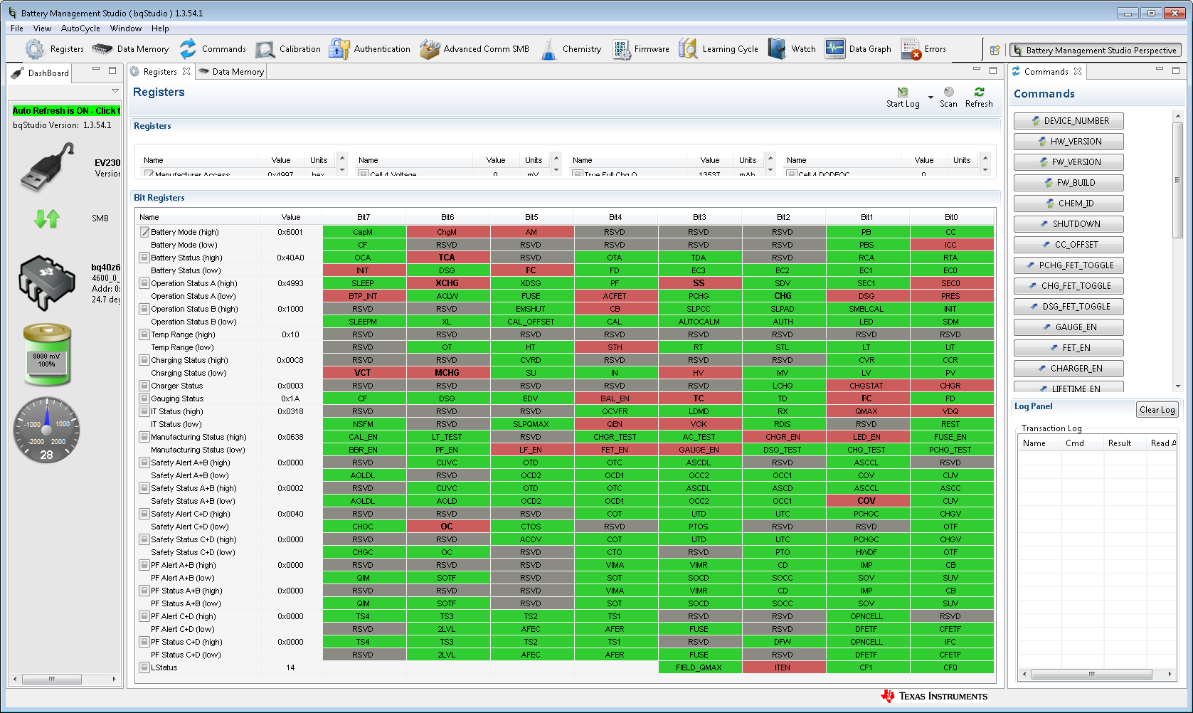

Here are the Bit Registers of concern:
TCA = 1,                Terminate Charge Alarm = Detected
FC = 1                    Fully Charged = Detected
XCHG = 1             Charge FET disabled = Detected
SS = 1                   Safety Mode = Detected
CHG = 0                Charge FET status = Disabled
VCT = 1                 Valid Charge Termination = Detected
MCHG = 1            Maintenance charge = Detected
TC = 1                  Terminate Charge Alarm = Detected
FC = 1                 Full Charge = Detected
COV = 1              Cell Over-Voltage = Detected
OC = 1                 Flag Over-Charge = Detected
