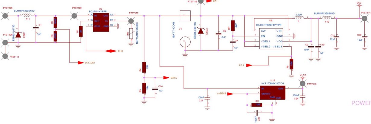

One of my customer has the following issue with our BQ25101H charger:
When they try to use a battery which is mostly charged (~ >4.1V), the /CHG pin stays at '0' (in charge mode) even if the charge is completed (Vbat>4.3V and output current measured at 0). It's finally going into a floating state after 1 or 2 hours. This behavior happens in both cases: with or without pic current coming from the system (TPS62743 + NCP170). Note that if the battery is removed during the issue, /CHG remains low.
If they use an empty battery, the /CHG signal works properly.
You will find below the schematic of their board. The CHG output is connected to a 40kohm pull-up.
Could you explain us this behavior?
Is there something where we could act to solve it?
  • As you indicated it sounds like bq25101H is not completing charge. The fast charge current set by R1 is 67mA with termination at 10% of that or 6.7mA.
    A couple of things to check:
    1.) Voltage on the battery, should be 4.35V.
    2.) Measure voltage at ISET with a scope with input current to system, compare input current with voltage at ISET.
    3.) Look for ripple or noise on the voltage at ISET near termination.
    4.) If a high ripple is present the Optional RC ckt, 2.7k and 10nF figure page 22 may help
    Note -- /CHG will be low during the first charge cycle only after that it will be float.
