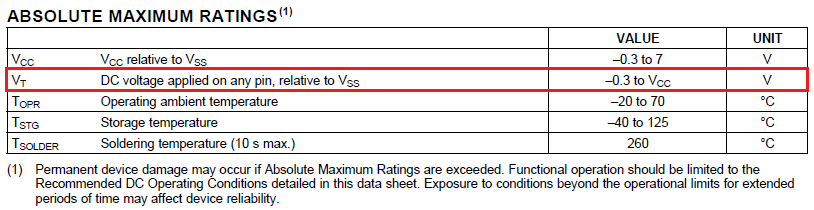

The datasheet shows the following about VT.

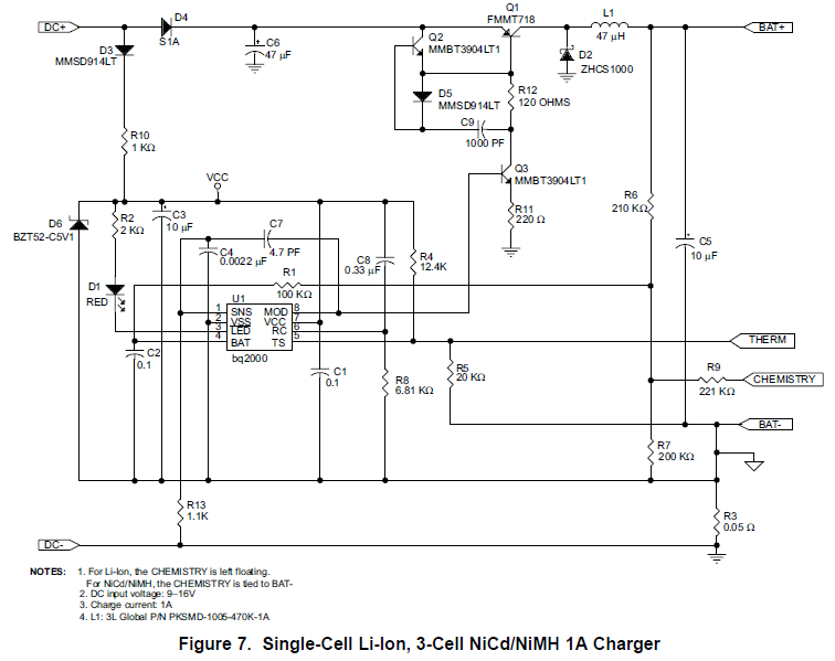

Is it possible to disconnect DC+ input (VCC) during battery is connected?
I would like to know if it is possible or not regarding the following typical application.
