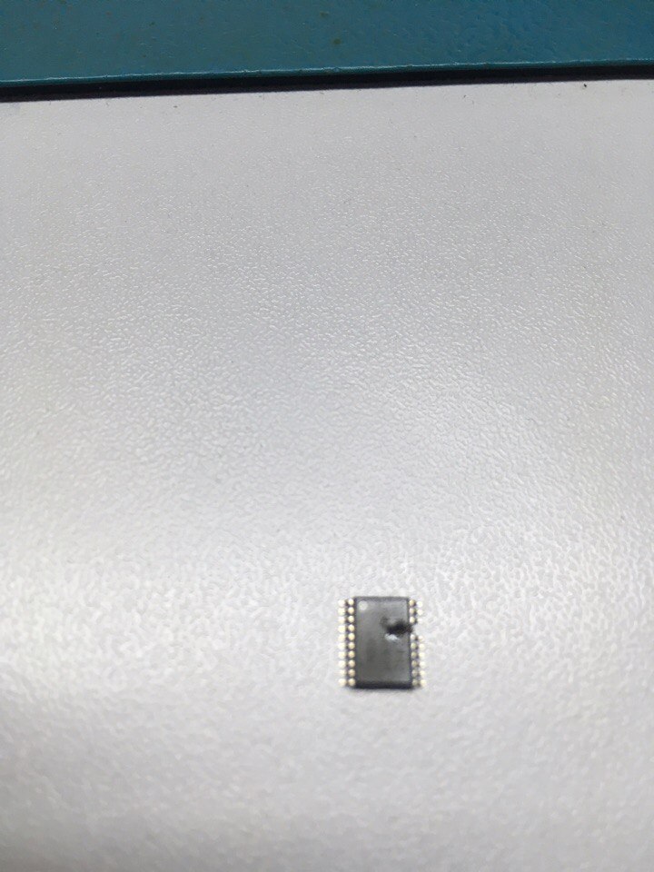

Hello! After some month of succesfull using TPS2482 one trouble thing begins. Sometimes TPS explodes in the area of SENSE pins, in that moment GATE pin is LOW and INPUT voltage is about 24 V. In what case such thing can be happend again and what protection additional circuits you can suggest to avoid this. Speaking about TPS2482 circuit which we are using, it was copied from datasheet and app note for dev board. Thanks!

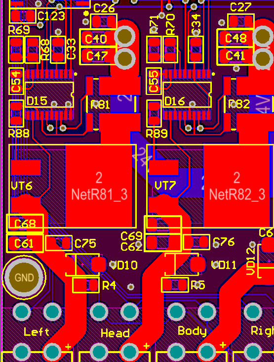

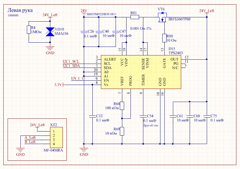

  • Thanks for answering. Here i post shcmatic and pcb design of TPS2482 which we are using. Can you inspect it and give me some suggestions to improve circuit protection. According to the circuit we are using TVS diode only in output part of FET, we have to use the same TVS in the INPUT part of FET? Thanks!
  • Alek,
    Input should be a unidirectional TVS. Output should be a high current Schottky. Durng faults, the FET is shut off quickly. Full fault current is flowing through parasitic line inductance, which can be high. Polarity changes on the parasitic inductance and a very high positive voltage is then on Vin. Vout will go very high negative voltage. The TVS and Schottky have to be sized to absorb the full fault current and clamp Vin and Vout to levels to protect the circuit and anything else on the busses.
