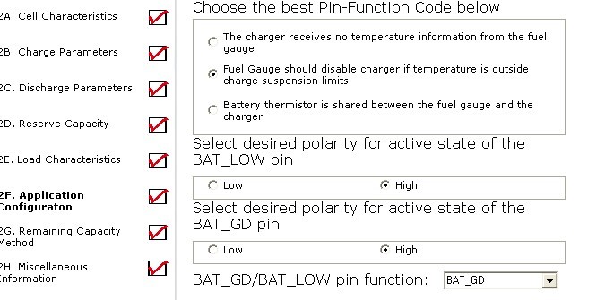

We target to use BAT_GD pin default low and high when only temperature out of range.

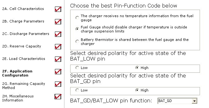

We was using default 1.12 DFI file as 1B in bqEasy and we got and configure the section 2 as all attached picture:
The questions :

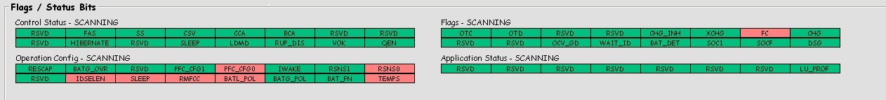

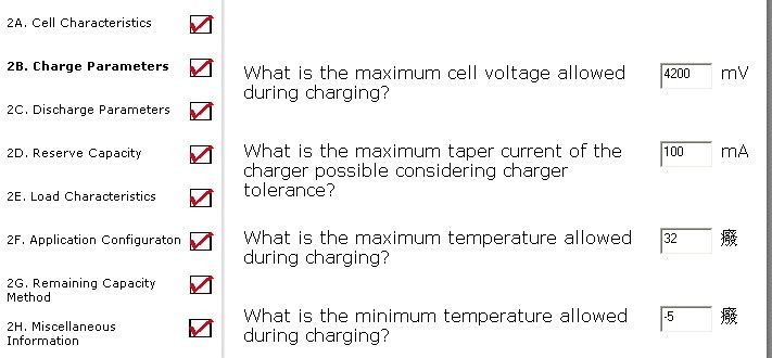

1. We can configure BAT_GD default low with EV2300 now. And we can also mesure the right current, voltage and temperature, but we set the temperature range of charging from -5 to 32 c-deg, and warm the battery to upper than 32 c-deg, the BAT_GD pin still LOW, it mean the charger still charging.

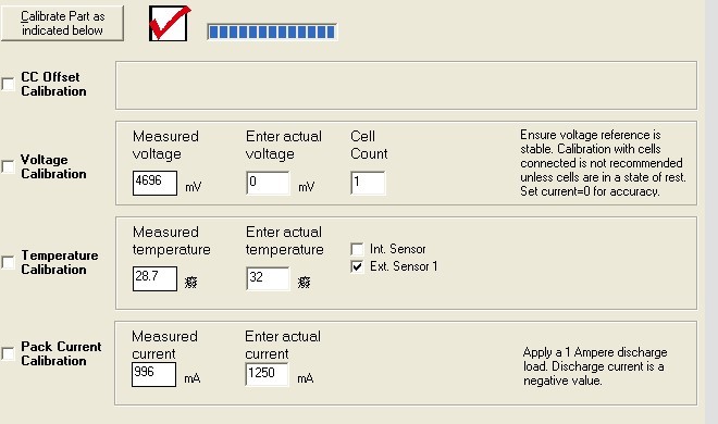

2. The BAT_GD  will be high since we click "Calibrate Part as indicated below" as picture bqtw-2.jpg, the mesured current was zero, and we pulled the Adapter out, the pin is low as default and mesured current is "-, x<0" discharging and replug apapter again, mesured current is "+, x>0" charging.
3. In the first picture, how the red or green color meaning?
