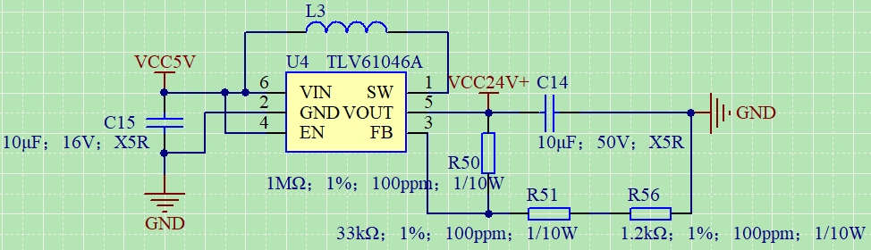

Dear ,
If the output Voltage is 24V, what about the value of current? And how long it will last?
Vin=5V
Vout=24V
it also relate to the inductor. Please follow the equation (2), (3), (4) of the datasheet to calculate the inductor peak current. setting the maximum inductor peak current to 850mA, you can calculate the maximum output current.
it is constant current. it will last if IC junction temperature is lower than 125oC
