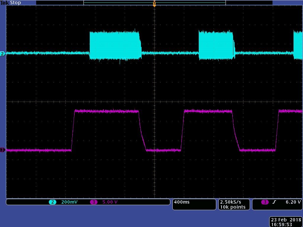

Hello!

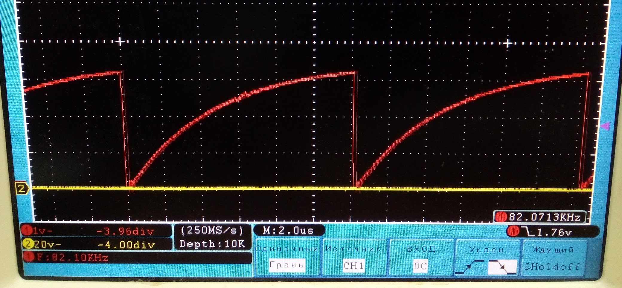

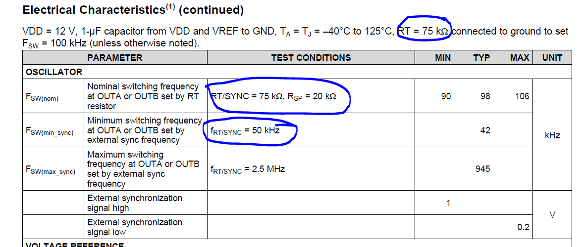

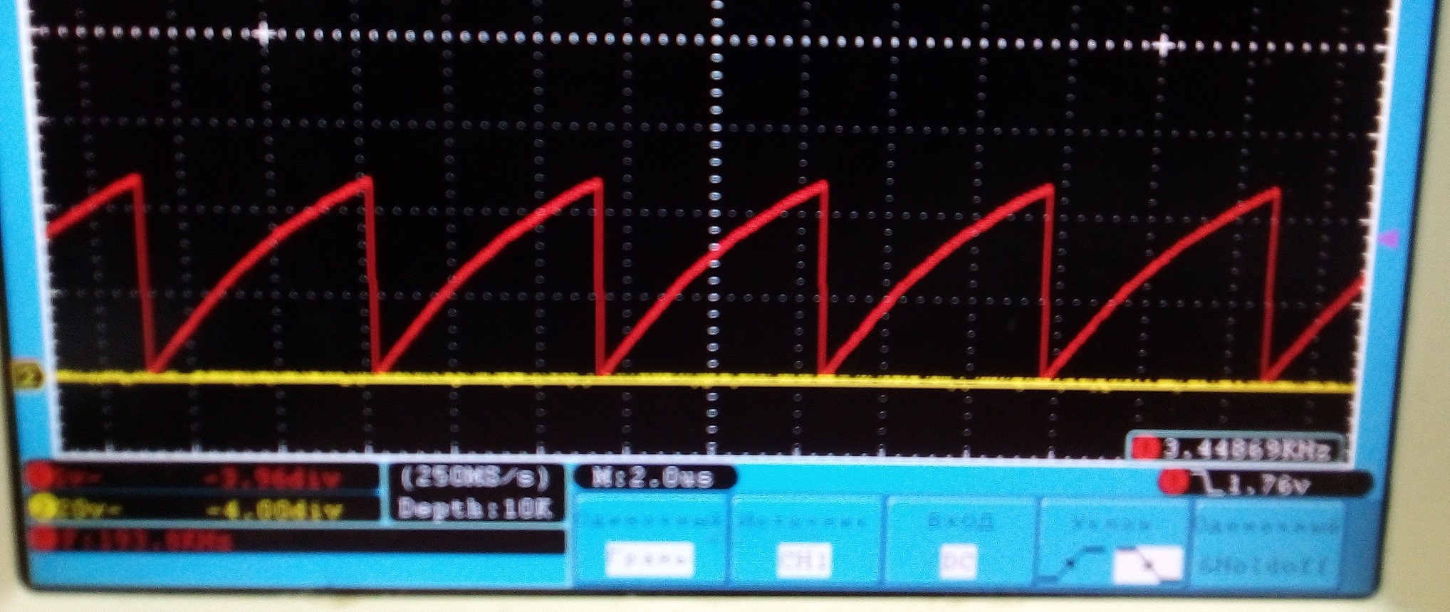

I have a problem with switching frequency after power-on. In my circuit Rt = 75KOhm (Fsw = 100KHz), Csoftstart = 100nF.
When I "power-on -> power-off -> power-on immediately" -> Fsw = 50kHz.
When I "power-on -> power-off -> wait for 15s -> power-on" -> Fsw = 100kHz.
When I "power-on -> power-off -> discharge Csoftstart immediately -> power-on immediately" -> Fsw = 100kHz.
What happens with Fsw after fast power cycling?
