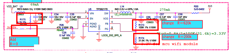

Dear TI member,
I use TPS62170 . For some IQ issue and cusomer's demand, Feedback resistor values need to increase to RTOP=620K, RGND=200K.
Could I use this values? What do I modify the circuit?
Thanks!
  • Hi Julian,
    Yes you can use R173=620k and R174=200k for the feedback resistor value. You can find more details in section 9.2.2.2 of the datasheet. It is recommended not to exceed 400k for the bottom resistor.
    What is the customer's Iq requirement?
  • Hi Sabrina,
    They just want to increase the feedback resistor to reduce the feedback current for lower IQ.
    They don't have any SPEC about Iq.
    Thanks!
  • Hi Julian,
    This app note explains more about selecting these FB resistor values: www.ti.com/.../slyt469.pdf
    This one discusses Iq: www.ti.com/.../slyt412.pdf
    I believe you want to reduce the 'no load' input current consumption, since the Iq cannot be changed. As SLYT469 shows, the FB resistor values have a small impact on the light load efficiency--your actual system load is dominant.
    As the D/S notes, for lowest current consumption, please use the fixed 3.3Vout TPS62172 device.
    Finally, the TPS62125 and TPS62177 are similar ICs which have lower Iq. The TPS62125 is also pin to pin with TPS62170.
