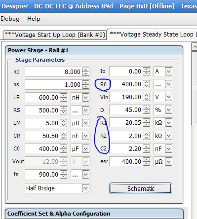

UCD3138: Fusion Power Designer offline mode problem
Part Number: UCD3138
When I use Power Designer offline mode for half-bridge LLC loop compensation simulation, I found there are some parameters that doesn't appear in schematic.
1. What is R0, does it refer to load resistor value?
2. Is R1, R2 and C2 refers to the voltage divider and the decoupling-cap in feedback loop?
