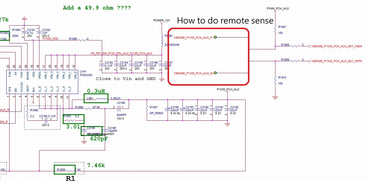

HI Sir
May I know how to do remote sense on TPS53355?
  • TPS53355 does not support differential remote sense internally. You would have to design an external remote sense circuit. We may have a reference design for remote sense. I will look for it.
    You could consider TPS549D22 which has built in remote sense capability.
