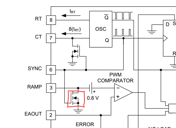

The current discharge of RAMP circuit is specified on page 5 of  the datasheet: I_R(sink)=12mA min and 19mA typical.
Which parameter influence the dispersion of this discharging current?
Moreover, in case CT and RAMP are not connected (in peak current mode control for instance), what is the current discharge value of pin CT?
Yves.
  • Hello Yves,
    The RAMP Sink current is determined by the Rdson of the internal FET marked in red.
    Another point: If RAMP and CT are not connected then there is no current at RAMP pin, thus no sink current. Please correct me if I understood it wrong.

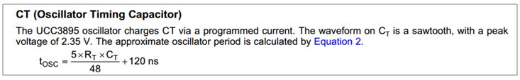

    where is the minimum discharge time specified? is it the 120ns to add in the Tosc calculation?
    Secondly my first concern was about the current discharge dispersion (or Rdson of discharging FETs).

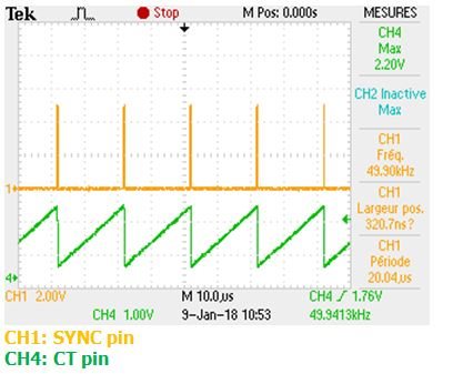

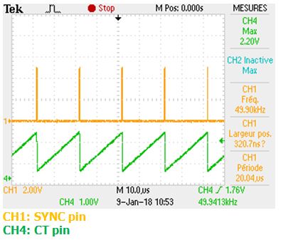

    I am planning to use an external signal to generate the clock of the UCC2895 using SYNC input. I set Rt, Ct, and SYNC pulse width to get the correct Ct signal. But this configuration is ok for typical operating conditions,  Idischarge=20mA. Below is what I measure:
    OK.

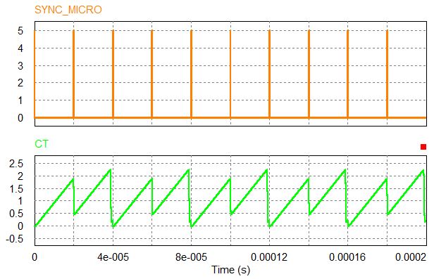

    But due to dispersions, the minimum discharge current can be reduced by half and reach 12mA as specified in the datasheet. In this case, the CT signal simulated is given below:
    Ct signal is not stable. ( I implemented UCC2895 model based on block diagram and Oscillator block diagram given in the datasheet )
    It is necessary to set the Ct, Rt values and SYNC pulse width to cover Rdson variations, but the dispersion is to wide.
    So I need to know which parameters mainly influence the variation of  Rdson of the discharging FETs.
    I guess the main contibution come from manufacturing dispersion, temperature change (-40°C to +85°C in my case) and steady state Gate signal voltage.
    Is it possible to get the detailed contribution of all those parameters so I can set the good couples of Rt, Ct and SYNC pulse width for my application, please?
