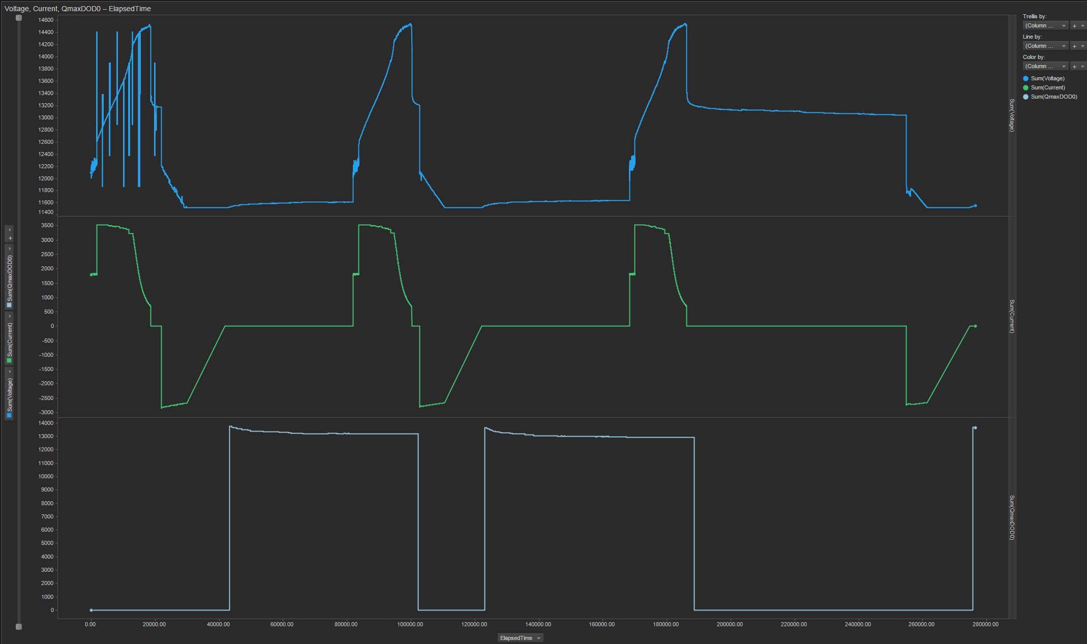

BQ34Z100-G1: HELP: Learning cycle with BQ34Z100-G1 and Lead acid, the update status stack in 04.
Part Number: BQ34Z100-G1
Other Parts Discussed in Thread: EV2400, BQSTUDIO
Hi there
recently i use BQ34Z100-G1 gas gauge IC with PbA, when i doing the learning cycle, the update statu always stack in 04, now i post my gg file and operation step that you check
is it correct???
(1)BATTERY
i use the lead acid battery what is 12V, 6 cells(EVH 12390), and chemistry ID is 807.
(2)gg file

  • Hi Wenity,
    There are still quite a few communication errors present in the log. I had to filter the voltage very heavily because of large values over 16000.
    I have attached the image of these filtered logs. Please allow time for the cell to rest after your first and second charge, before you discharge. Currently there is an immediate discharge after charging.
    Also, the gg.csv file was not readable. Many values have been set to 10. Please do not open this file in excel and save it - it will corrupt the hex values and convert floats to differing values of precision. If you did not open it up in excel, the file appears to have very odd values.
    1) Perform another learning cycle, but allow the cell to fully rest after charging and before discharging.
    2) After the third charge in the image below, the cell has still not rested.  Please allow more time to rest.
    3) Please send another gg log from your device before and after your next test.

    now looks like it is too short of rest, so i will follow the step and take longer rest before charge and after discharge.
    wish me luck.
    thanks
    wenity 2018/01/22
  • Hi Wenity,
    Just a stab in the dark, but are you using an EV2300 V3.1C? If so, the firmware requires and update. Those files can be found here: e2e.ti.com/.../3225.EV2300FWUpdaterUnprogDev.zip
    If not, please disregard.
    I wish you luck on the next cycle!
    Sincerely,
    Bryan Kahler
