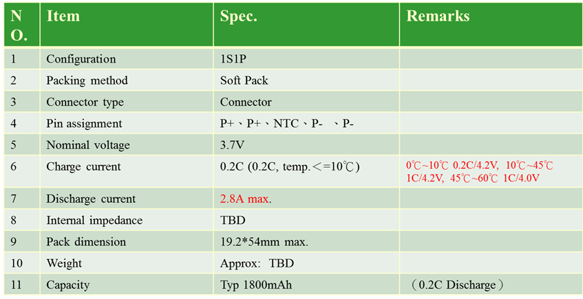

Could you please provide suggestion on a gas gauge solution based on the battery spec below?
The customer selected BQ25890 as the charger and they once used BQ25741 as the pack-side solution.
They are now looking for a system-side solution.
