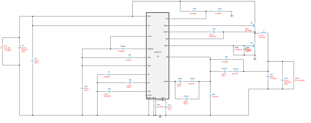

I'm using the TPS40170.  I designed it in webench.  Input voltage is 10-36V, output is 4.5V at 7A max
I have my design up and running.  Initially I had problems with switching noise getting on the high side mosfet gate causing occasional short circuits (as both mosfets were on) at certain input voltages.  However, some extra low value ceramic capacitors on the input power rail near the high side mosfet fixed this by removing noise.
Now all seems to be working, however my low side FET is getting hot.  At 12V it is around 90*C, and at 24V it increases to 110*C approx.  Attached is my circuit diagram.  The thermal simulations I have run, show the low side FET being a lot cooler (80*C max - no fans).
Low side FET = BSC340N08NS3-G
High side FET = CSD18543Q3A
I could do with some input on what to look out for to lower my temperature.  I've had to increase the Rlimit capacitor, as at 6.5A it was starting to limit itself, due to the increase temperature in the low side FET.

    It looks like WEBENCH recommends a low-side FET with Rdson=15mohm where yours is 34mohms. That may account for some of the temperature discrepancy. Did you chose your low-side FET for the WEBENCH sim? Can you share your WEBENCH file so I can be sure I'm on the same page? (Top right of WEBENCH page, "Share Design - Share with Public - Get new Shareable Link"
    Another big factor is layout. That can have huge effect on performance. Can you share your layout as well?
    -Sam

    Thanks for the reply.  I've now replaced the low side fet with one with a lower RDSon and its a lot cooler.  Its just the simulation file on webench that threw me.
