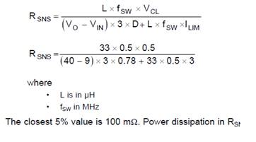

I am confirming LM5022 datasheet P.21 Rsns equation(36)
I solved this, the result is 0.0676.
I think closet value is 68mohm, but selected 100mohm, although there are several resistances up to 100mohm.
I'd like to know why 100mohm is selected.
Plus I don't know the meaning of tripling in the equqtion(36) of (Vo - Vin) x 3 x D.
I appreciate your great help in advance.
Shinichi
  • There is another E2E thread in which Garrett presented the derivation of these equations, and explained the why 3x is introduced. Designers usually use K>1 for margins. These equations just give you a guideline and you can select 68mOhm but 100mOhm might be an more available part when the designer of the example circuit was selecting parts. With different Rsns, you may need to adjust Rs1 and Rs2 in accordance.
    Please check the following link so I don't need to duplicate here.
    e2e.ti.com/.../653822
