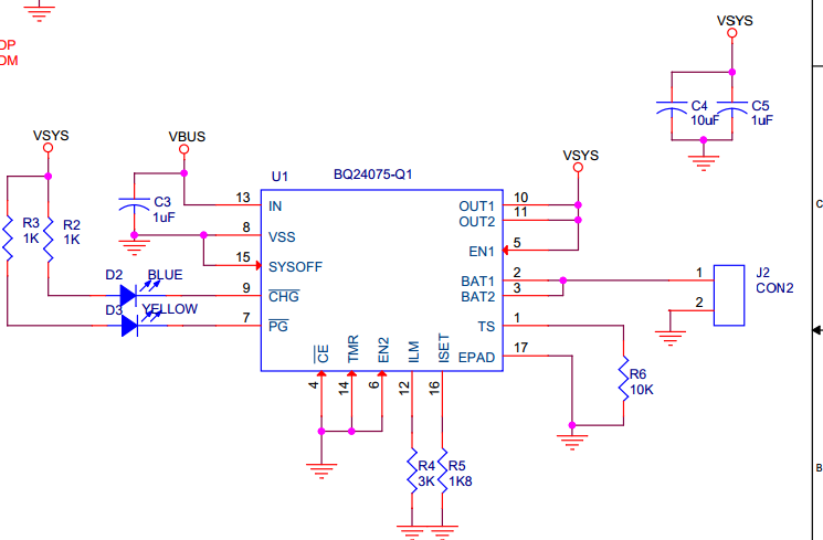

Hi,sir,
I used BQ24075-Q1 for battery charge and the schematics is as following:
If the battery is absent, CHG pin still goes low. The charging function goes well but CHG pin is always low even it's completed. I reviewed the datasheet again and added 100K pull up resistor of CHG pin, but there is no change and CHG pin is low too.
Wait for your reply. Thank you!
