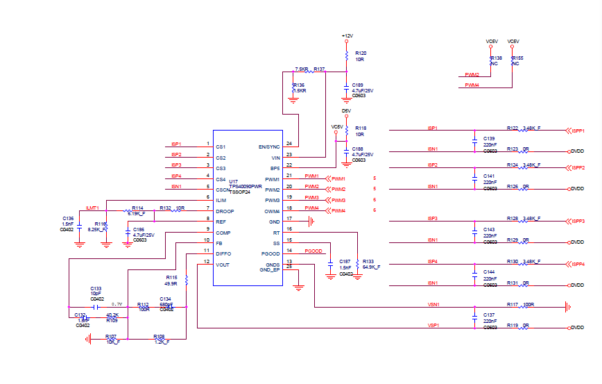

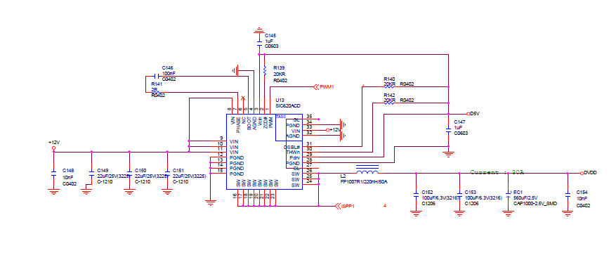

Our design needs to meet 120A,But we test it only meet 80A,can you help me check the Circuit? Is the Rcs OK?
Hi Qian,
Actually, I think customer would like to know what the Rcs means at page11 formula 5 in DS? Is it DCR? or current sense mohm resistor?
Thanks.
