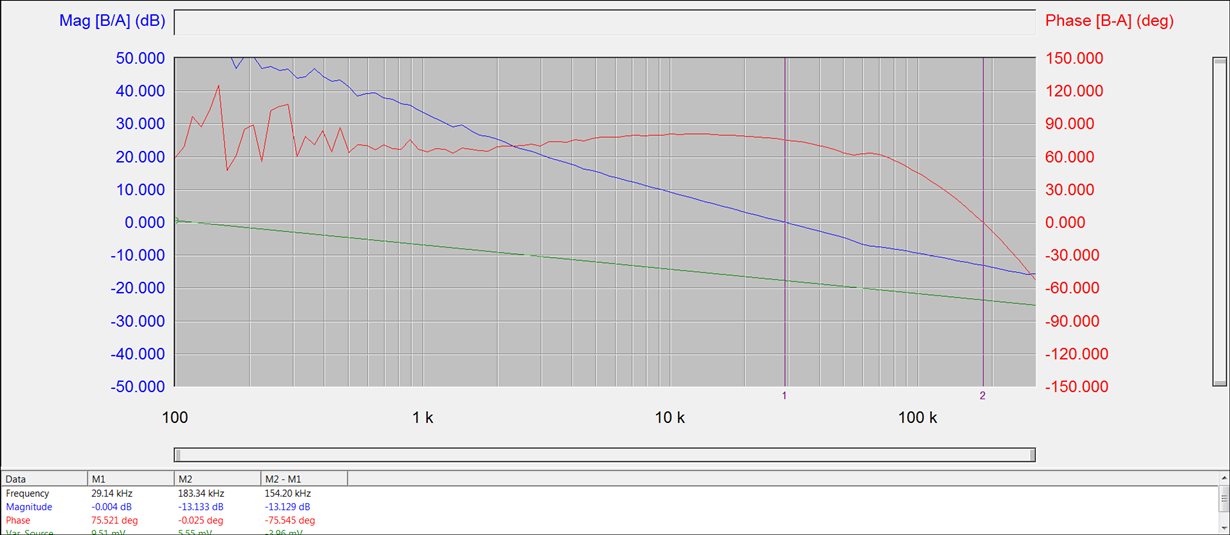

I am running the bode simulation in the webench of the TPS61087-Q1 and see a high Q peak at half the switching frequency, which I would expect if I would have a standard current mode control boost converter with >50% duty cycle and no slope compensation. However, there is no mention of slope compensation in the TPS61087-Q1 datasheet and it also completely disregards this additional pole to consider when designing the compensation network. Further to this, earlier versions of the TPS61087 datasheet explicitly mention that:
"Because of the quasi-constant frequency behavior of the device, the TPS61087 eliminates the need for an internal oscillator and slope compensation, which provides better stability for the system over a wide of input and output voltages range, and more stable and accurate current limiting operation compared to boost converters operating with a conventional PWM scheme."
Thus: Does the model of the TPS61087-Q1 in webench reflect this behavior of the chip in the bode simulation, or does it act as a standard PWM controller and therefore lead to wrong results?
Attached the esim report from webench...

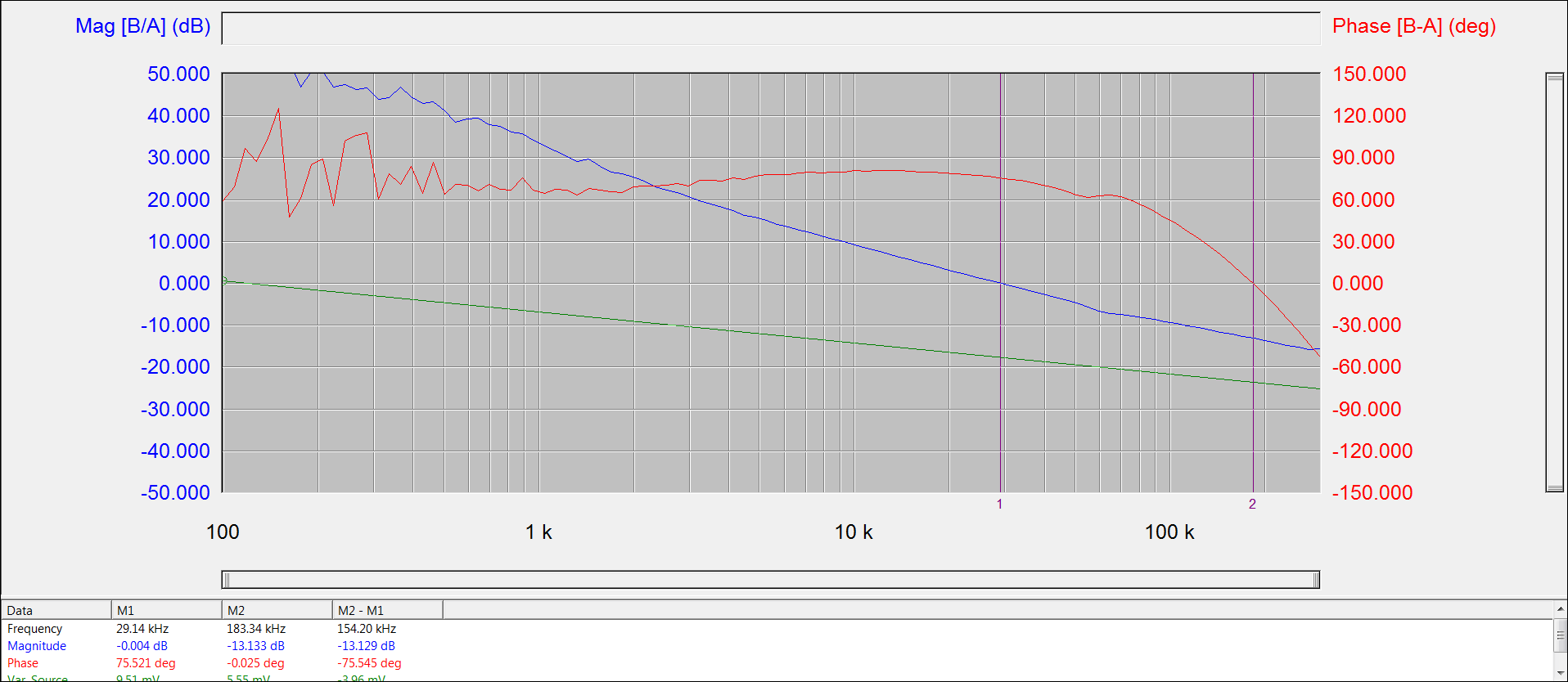

  • For the TPS61087, it rely on the external compensation since there's a COMP pin. And reduce the value of Rcomp also helps.
    I can test a real bode plot for you if you need it.
  •  The real bode plot is different with your simulation result. Please check the attached file. So the Webench model needs to be updated.
    Thanks for going through the effort and testing the real loop gain of the device. I just want to confirm, the above result you attached, is that with the same compensation network and power stage as I have attached in my webench results in the first post?
    Can you envision when the webench model will be updated?

  • Yes, I use the same parameter as what you used in your first post sch. The modeling team is a totally different team. They need at least 1-2 month to update the model.
