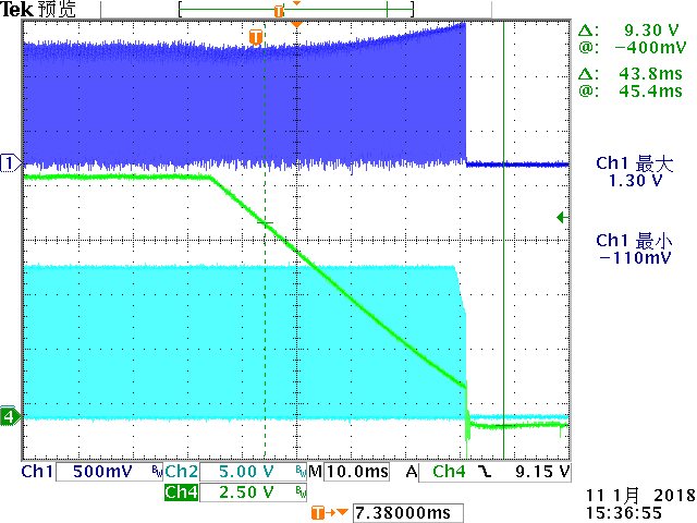

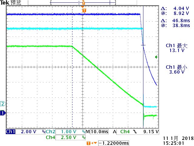

  • The picture below: dark blue- VCC, light blue- VREF, green- output. We can see that the output voltage decrease is not caused by UVLO
    the picture below: dark blue- CS pin, green- output voltage, light blue- OUTA. We can see that the output voltage decrease is not caused by CS.
    The voltage should decrease, but the holding time from device to device varies greatly. I plan to send the failure parts to the CQE lab, but I doubt whether it can help me determine the root cause. If any ideas, please let me know.
  • Hello Howard
    Thanks for the added information and I would agree with your conclusions
