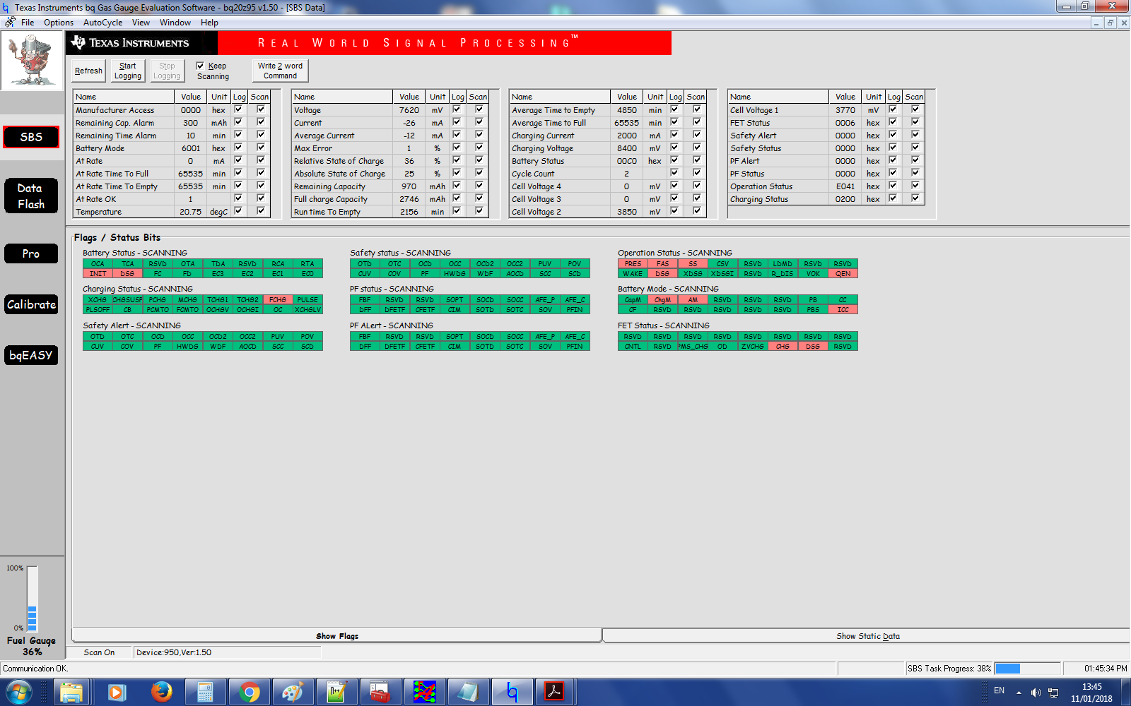

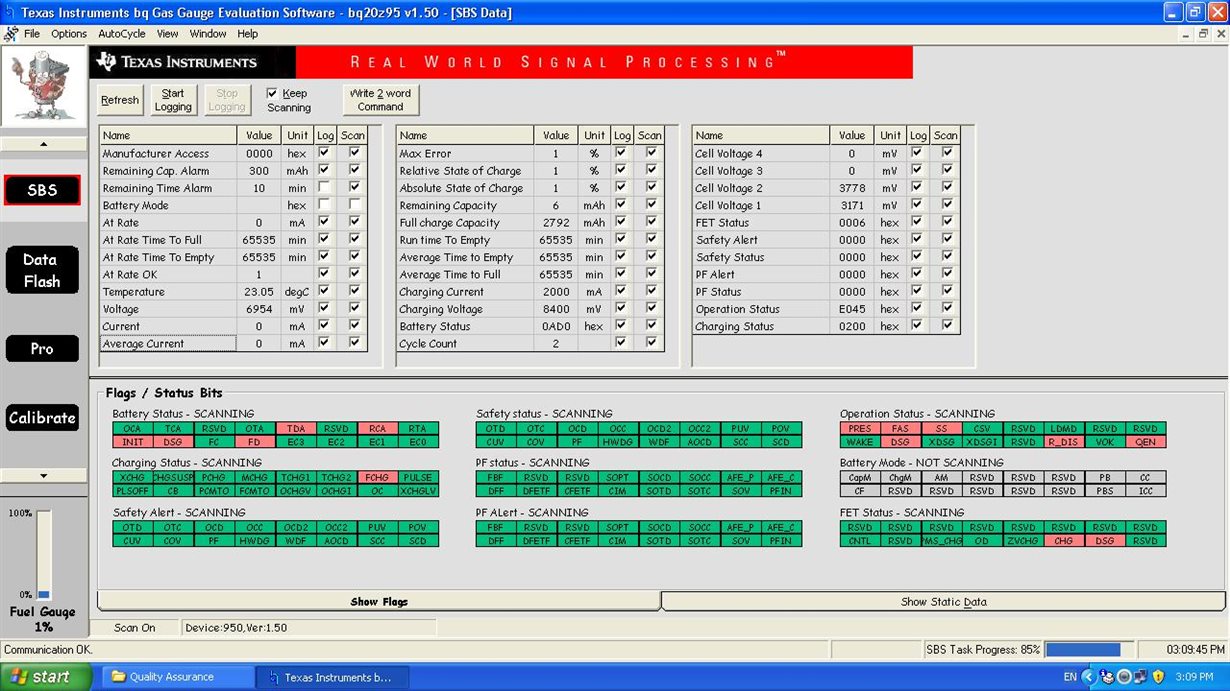

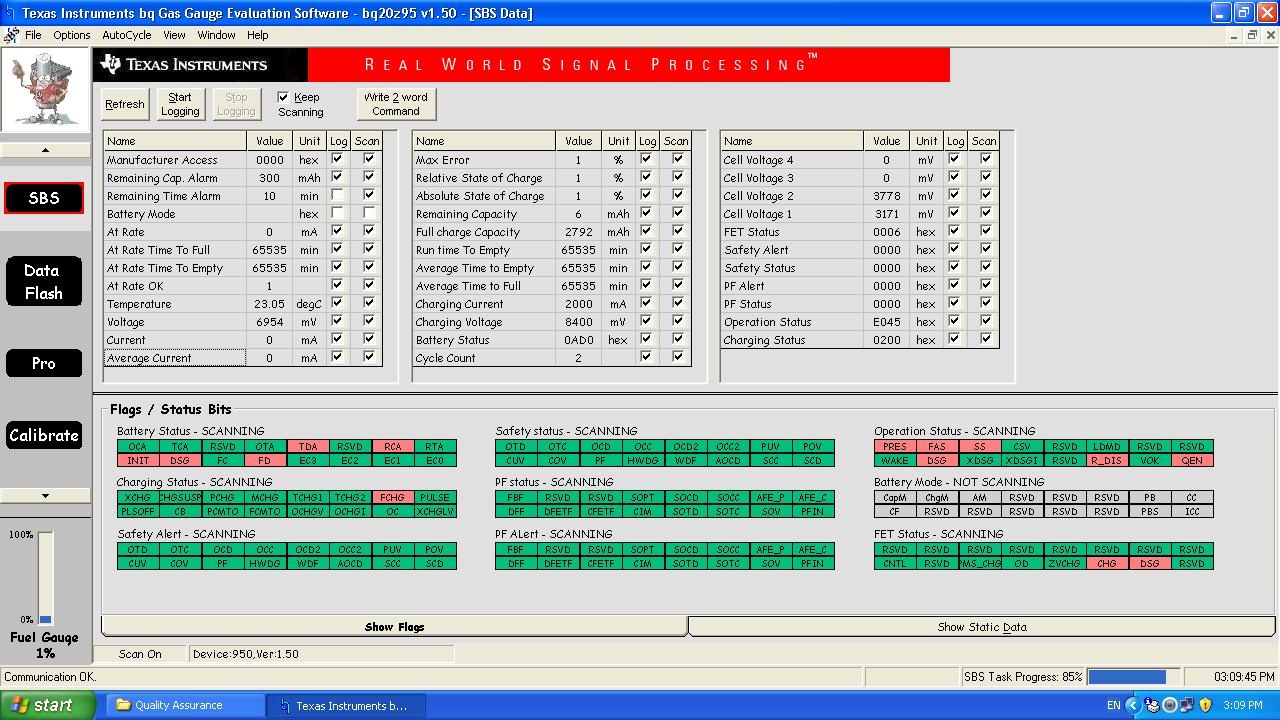

We are using 2S1P LI-PO cell (4000mA) connected to PCM(BMS) board (attached schematic).
Our battery = 7.4V@4000mA.
Recently, we encountered large amount of failure (50%) with new batteries.
50% of our failure related to:
    1. cell balancing failure.
    1. full discharging during shipment.
    1. Low capacity.
We are looking for the root cause.

  • Hi Bryan,
    Thanks for the fast reply.
    Attached example of one of the battery log snapshot using TI SW.
    This is after air shipment.
    Please advise if you need more information.
    Avi

    Thank you for the image of the registers, schematic, and gg file.
    Could you also send a few text logs from some of the affected devices and mark them based upon the mechanism of failure: (1) cell balancing (2) full discharging during shipment (3) low capacity.

  • Hi Avi,
    Thank you for the inline comments - as asked previously, could you please send the logs of the failing devices, corresponding gg file, and modality of failure?
    The screenshot of the registers does not give me enough information to analyze the device or begin to determine a root cause.
    If you would prefer not to disclose the logs publicly, we can continue internally with e-mails.
