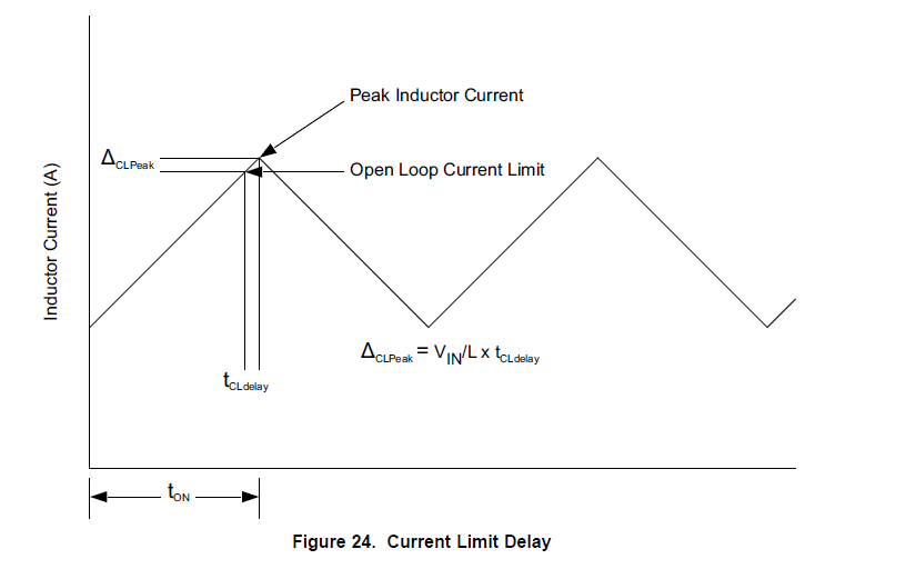

  • Thanks for the guidance. And sorry about using giving you the wrong figure. I was looking at the Q1 datasheet. It looks like their are some really subtle differences.
    Any how it was the above diagram. I was wondering how to correctly interpret this. Am I suppose to assume that the tCLdelay starts when the Inductor Current  reaches 'current limit' and the peak current I will see is:
     (Current Limit) + ΔCLPeak
  • This curve shows that the bench measured peak current limit will be slightly larger than the number given in the EC table on the datasheet, due to internal comparator delay. The delay is from when the comparator seen the current limit tripped, to the time when the internal FET is actually turned off. There's a small additional current seen during this delay time, which is the delta-CLPeak in the picture.
    This is not a concern unless you are actually operating in current limiting mode. This should only happen during fault conditions, not in normal operation.
    If your maximum DC load current is not above 5A, you should not see peak current limit in normal operation.
    Yang
