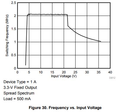

In LMR14206 datasheet there's an example design with Vin from 4.5 to 42V and Voit of 3.3V (the very first typical application)
WEBENCH doesn't accept this because of min Ton requirement failed.
Is it a datasheet error or a WEBENCH limit ? Can this part provide 3.3V output with 42V input ?
