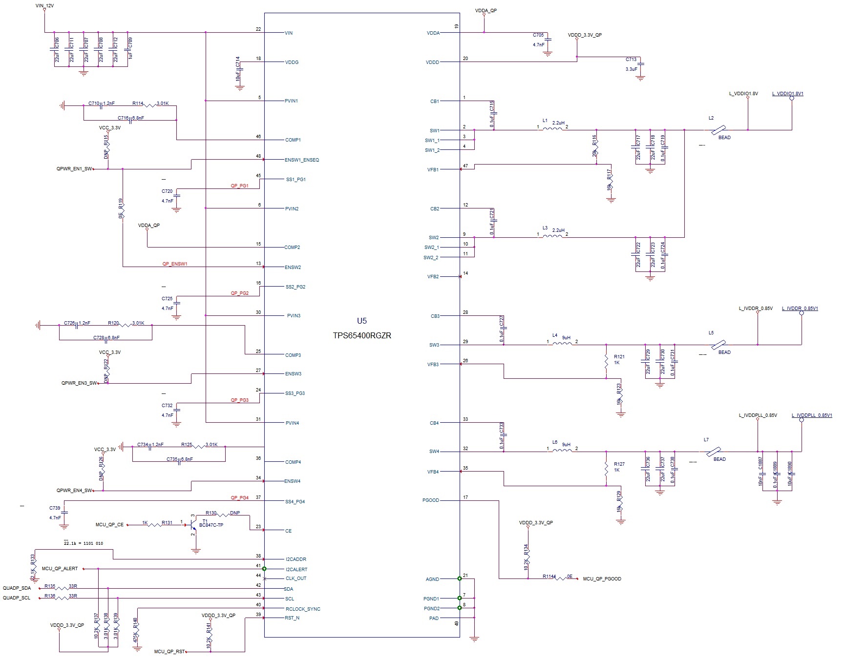

TPS65400: Current sharing on SW1 & SW2 & SW3 and SW4 are individual output
Part Number: TPS65400
Hi, I am using Current sharing on SW1 & SW2 only, not for the SW3 & SW4.
SW3 & SW4 i am using as individual output
My application is
1. On SW1 & SW2
Vin = 12V
Vout = 1.8V(Typ) range 1.8V to 1.9V
Current = 6A Max
2. On SW3
Vin = 12V
Vout = 0.85V(Typ) range 0.80V to 0.90V
Current = 1A Max
3. On SW4
Vin = 12V
Current = 0.5A Max
Output are sequenced  through external power sequecer IC.
Is my design approach correct?
Can I do current sharing on SW1 & SW2 only and SW3  & SW4  as single-single output?
