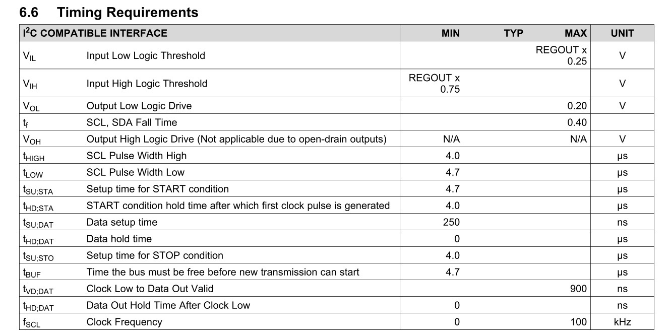

BQ76930: What is the I2C Rise and Fall time value
Part Number: BQ76930
Dear
After checking the "bq769x0 3-Series to 15-Series Cell Battery Monitor Family for Li-Ion and Phosphate Applications" doc, i only can know the value of I2C SCL, SDA Fall Time is 0.4 but i don't know the UNIT
Do anyone know what is the value for fall time and raise time for BQ76930
thanks
